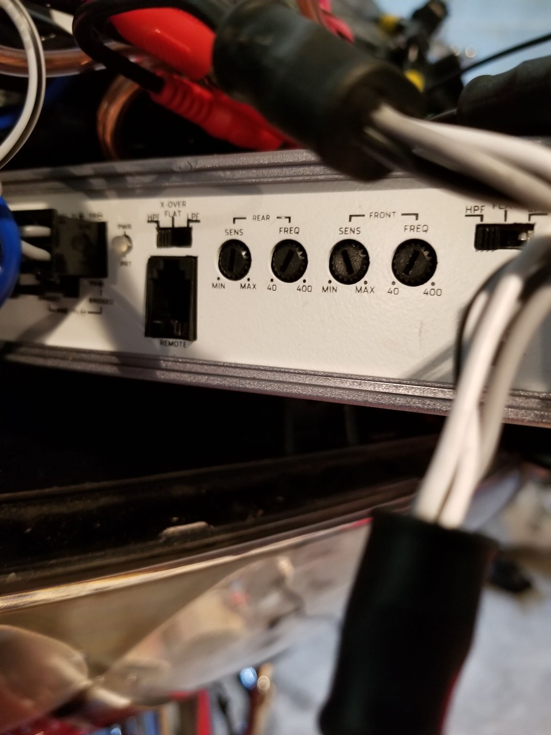

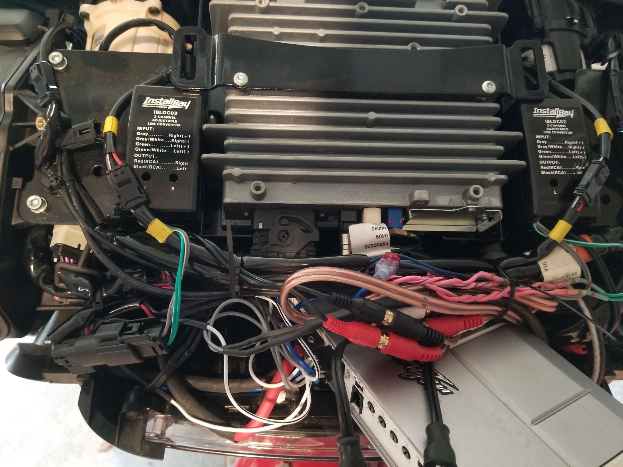

Ok so I've bought at rear bt355 and I will still need a front one. Took the fairing off just now. Here is a pic of how its hooked up now. There are iblocs hooked up to what I think would be where/how the bt355s would go. Is that right?
So how and where would the line levelers go? Would I just swap the line converters out for the bt355s? Or run them both.
also here are my amp settings. Anything that stands out I should adjust?

You'll want to get rid of those install bay LOCs and put the BT355s in their place. I can't tell much from the amp settings pic. I've not used one of the Stinger amps and there is no reference marks that I see in your pic. Did the clown who installed you gear cut the plugs off? I don't see those.
No Sound Solutions did all that crap last year. The guy that installed this amp and rf kit did a good job I think. He even replaced/made some plugs they had cut off I think. Soldered all the connections and put the heat shrink on all his wires.
But thats what I was worried about. The plugs they cut off. Can you tell if the plugs are intact to install the bt355s?
Also, what are those line out converters for? What do they do versus the bt355?
