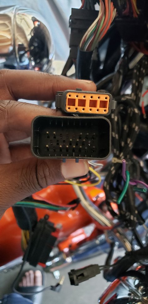

Aswc-1 plug and what i believe is the "Boom harness"

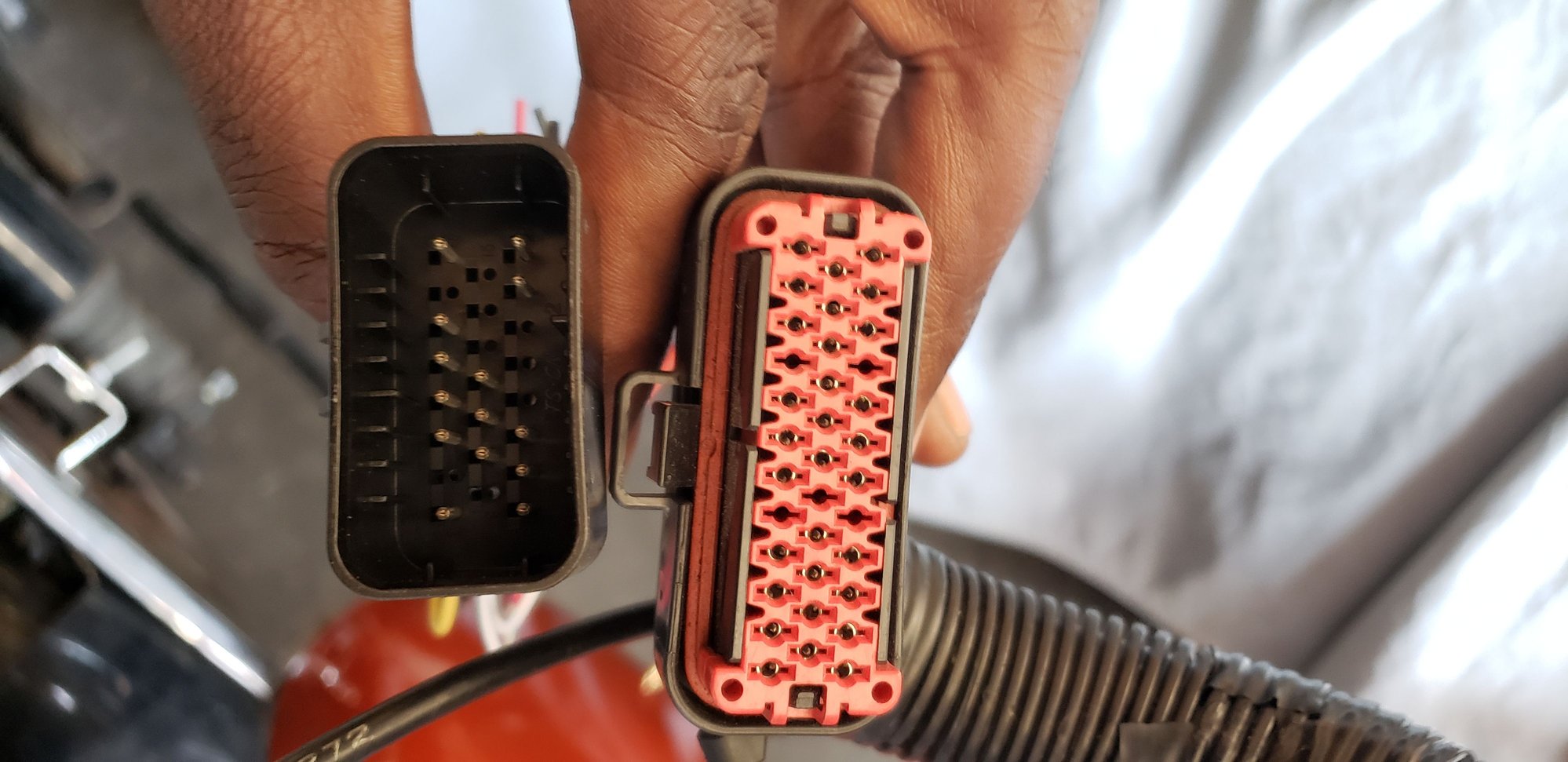

Aswc-1 and what I assume would've have plugged into the stock radio 🤷🏿*♂️
There is should be another plug. Same as this but smaller
The black 23 pin plug looks to be the same as the one that plugged into the Boom amp on my 2015 CVO Limited.
