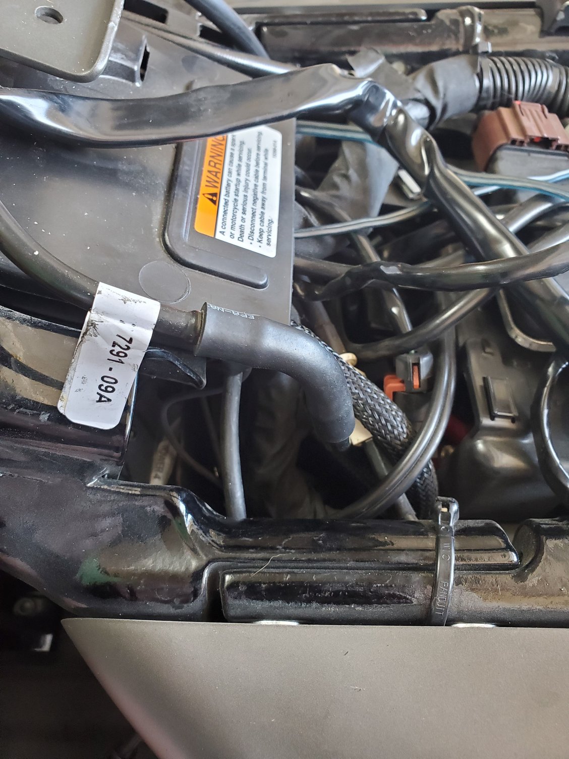

The tag gives part number 7291-09A. I looked it up and cant found it. I dont remember if it connects to anything. It's the elbow piece at the bottom of the photo. Does it connect somewhere under the battery?

Fuel tank overflow?
Would not connect to anything, just flows excess fuel to ground

Hard plastic hose (27291-09A) from tank to rubber angle piece to another hard plastic hose (27440-09A) that runs to atmosphere under the left side cover.

Ok all of that is intact. So it just runs to as a drain and does t need to connect to anything on the other end of the second hose?

Its connected to the gas cap area - then behind the side cover connects to nothing, overflow gas spills to the ground
