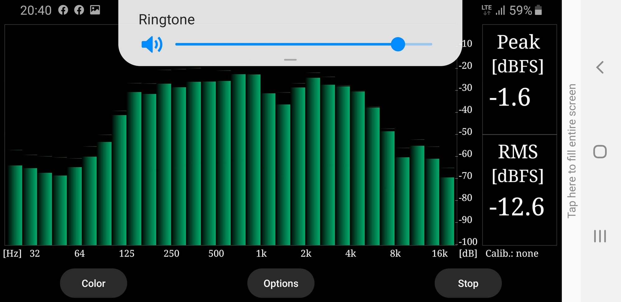

Bag 6x9 RF TMS69
Front prv 6.5 250 nyd
Old Sep 17, 2019 | 07:57 PM
pdave's Avatar
pdave
Joined: Apr 2017
Posts: 38
OK, I think I figured out that the issue is with the mic on the tablet I'm running RTA off of. When I turn the volume all the way up it flattens out the curve. I think it is just maxing out the hardware. When I turn it down the post above is what I get. The top pic is just the bag speakers and the bottom is just the fairing 6.5. I am new to this so I assume I just need to adjust things to flatten it out. Does anybody have any specific suggestions?

What software and mic are you using?

I would never trust one of those cheesy apps much less without a calibrated mic.

RTA Analyzer on an android tablet with a built in mic.
