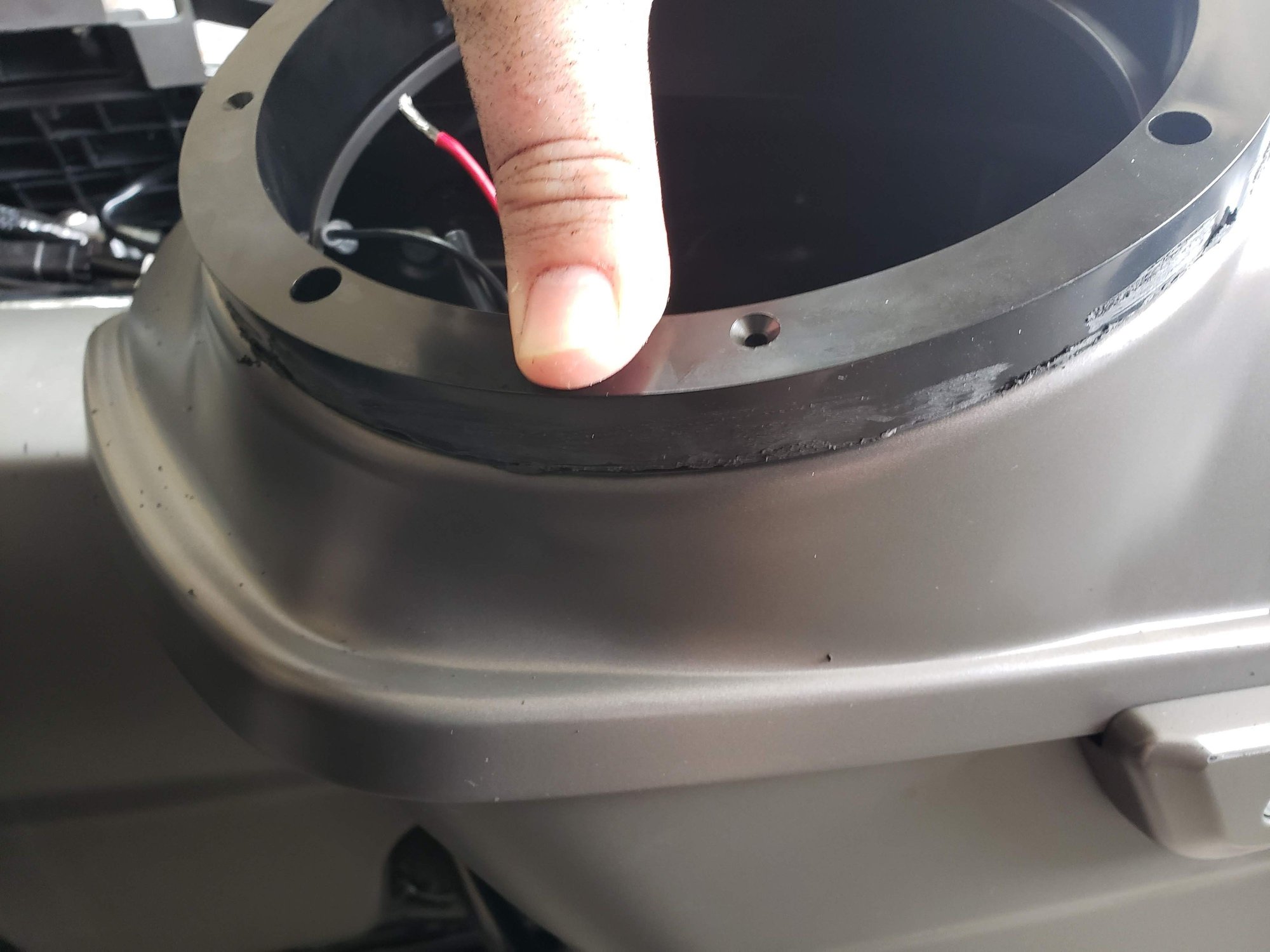

Old Oct 9, 2019 | 04:00 PM
GunslingersNation1's Avatar
GunslingersNation1
Joined: Jul 2019
Posts: 720
Likes: 48
From: Fort Worth
Maybe with my spacers?
