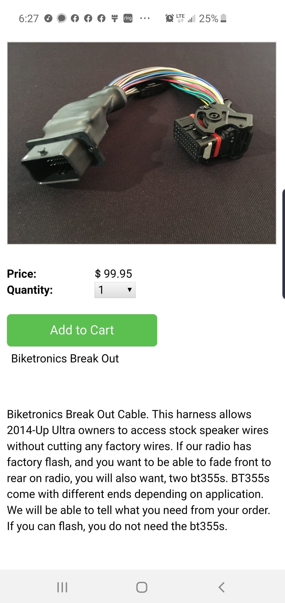

Has anyone used this before. If reading right, I will retain the factory speaker wiring.
Is your CVO an Ultra? If so then yes, this is what you need to retain factory wiring to your lids.
I would call Mike at Biketronics and confirm.
Mine is a CVO roadglide but when I looked up the harness part numbers, they were the same. But you are right, I will call to confirm.
You all have been amazing and i thank you for the help.
Now just a general question Harley advertises my bike as 600 watts. Will this new system with the parts listed be much louder? Just curious since the mmats 601 cx are advertised as 100 wrms.
The watt rating on your Harley system is extremely exaggerated. As far as those Mmat speakers go, they'll take up to 150 watts all day long. The setup that has been suggested will blow away what you have now, regardless of the watt ratings.
