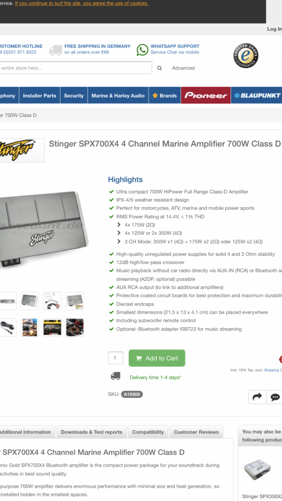

Old Feb 17, 2020 | 05:33 PM
mark16w's Avatar
mark16w
Joined: Sep 2019
Posts: 119
Likes: 7
From: Amsterdam
thanks for sharing the info guys thanks 🙏🏼
would the stinger be a good amp for me?
Yes, the Stinger 700 will serve u very well.
T
