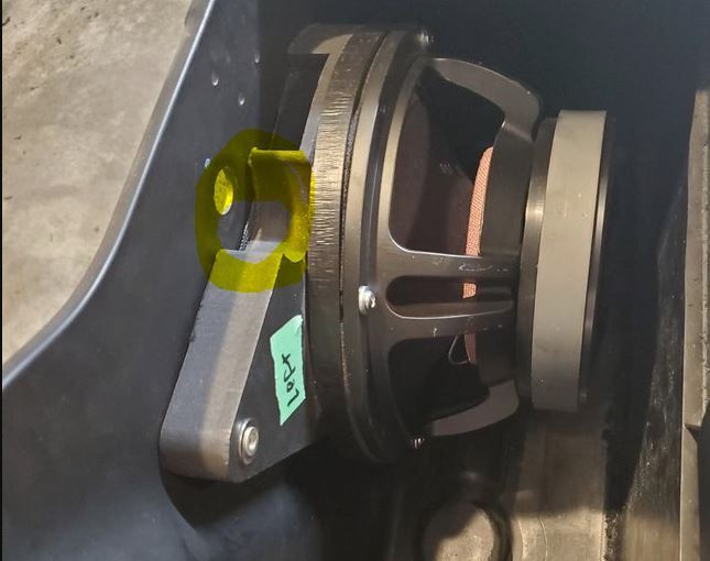

Enjoying a few beers Got it all cut and installed. Still need to get a final tune on it but it's much better than before. I see how this can become addictive.
Is it a speaker grill on the picture?
Inside the yellow circle between the bag and speaker mount? Yes.

That's not good. You must close this gap.
Why is that? To keep things out or would it effect the sound? There's a gasket between the grill and the bag and the grill and the speaker mount.
I used a flashlight and turned all the garage lights out. If you put the light around the edges of the grill on the outside and can’t see light on the inside, and put the flashlight inside the bag and can’t see light coming through from the outside then you should be good. If you can see light, water can get in too. I also treated my speakers with Never Wet.
Holes around the speaker will effect sound. Air leak will kill the bass.
