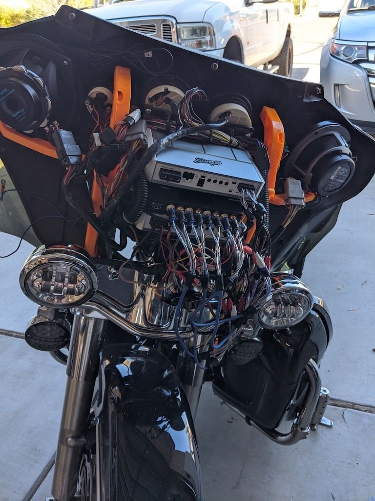

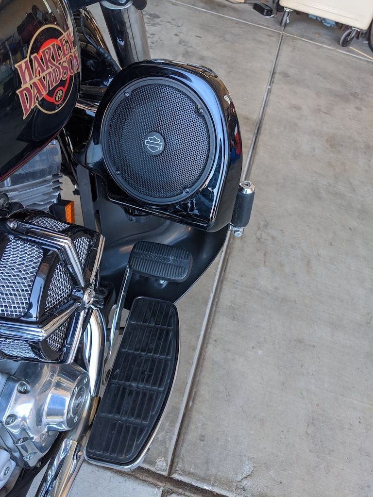

So, I've gotten all the equipment installed and wiring is mostly done for my new setup (Dual Stingers, Dayton DSP, Beyma 6.5's and tweets, Faital 6.5's in lowers, etc). The depth of sound is just phenomenal and blows away my old setup. Anyway, I'm still messing around with the tuning (and probably will for a long time since I can't leave stuff alone) but I can't close up the fairing because I need the USB connector in order to tune the Dayton. I started thinking about removing my cigarette lighter housing and buying a new socket from Amazon that I could use to store and pull through the USB cable for tuning. Does anyone have any suggestions or do you just open up your fairing each time? Oh and here's a few pics during install but looks like I didn't take any "after" pics. BTW, I bought those CVO covers for my lowers from Outkast and they look FANTASTIC!

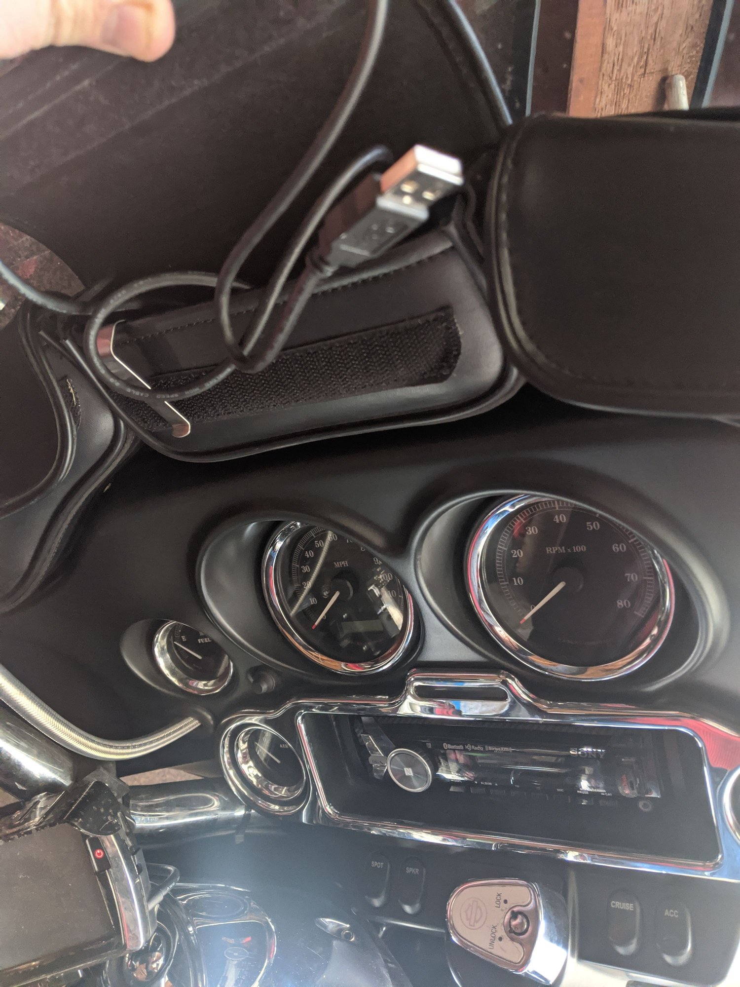

Here is what I did, hole through top of inner fairing into the bottom of my windshield bag.
