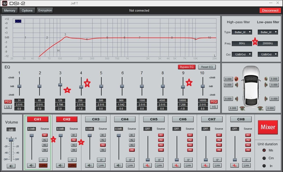

Well, got everything wired up, hooked up, but just getting ready to set gains and hit a snag
Stock head unit, stinger amp, DD dsi-2, mmats 601 cx in fairing, and same in TP. Without setting gains, I hit one bar on volume and its LOUD. If I keep going up, I’m sure near unbearable. Any ideas as to what might be doing this? Is it possible to be the tune in my dsp?

No flash, set at 4/0 already. I did unplug the speakers from the amp, and am not getting good readings in voltage out. Spoke to Andy last night and I am turning down the master volume on DSP and then trying again this afternoon.
DSP input voltage is straight from the battery.
I'm going to try the master volume at -10 first and go from there. I already have the gains (front and rear) at zero and have tried small adjustments.
More details this afternoon I hope. Maybe the one change will make things fall in line.
