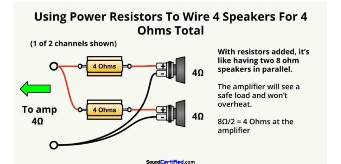

Do you have a pair of horns on each channel of the 250
how do you wire 4 horns to the sd250.2.
thanks
Old May 11, 2020 | 06:32 AM
ShawnJ1070's Avatar
ShawnJ1070
Joined: Sep 2019
Posts: 25
From: Gastonia, NC
thanks
