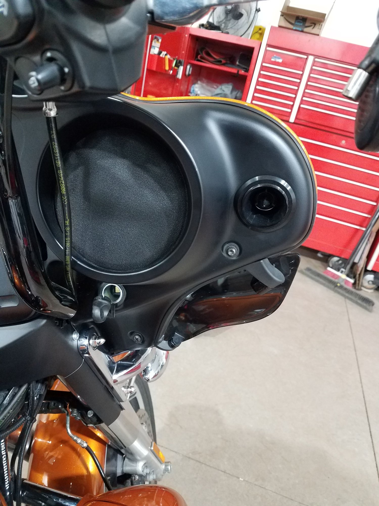

Most people mount them where the mirrors are.

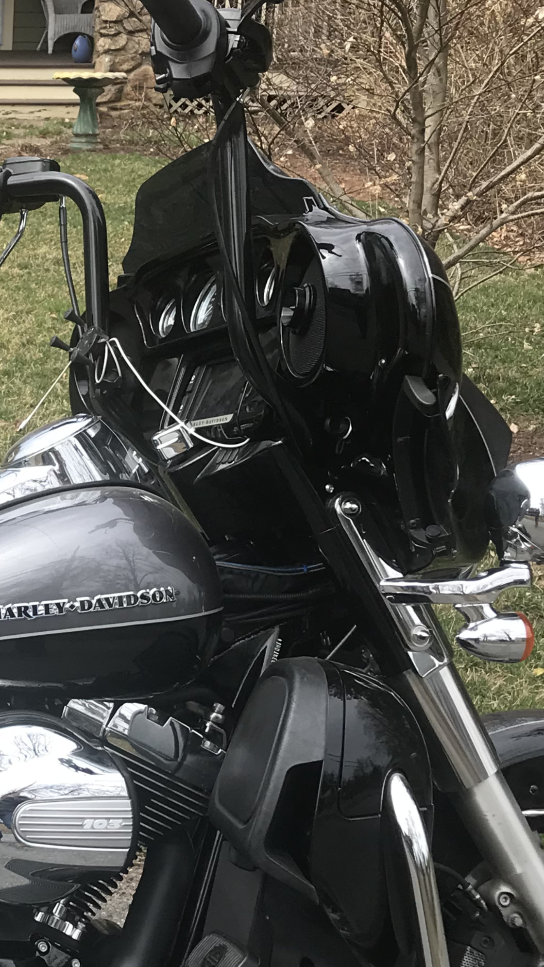

Or give up the volt and fuel gauges.

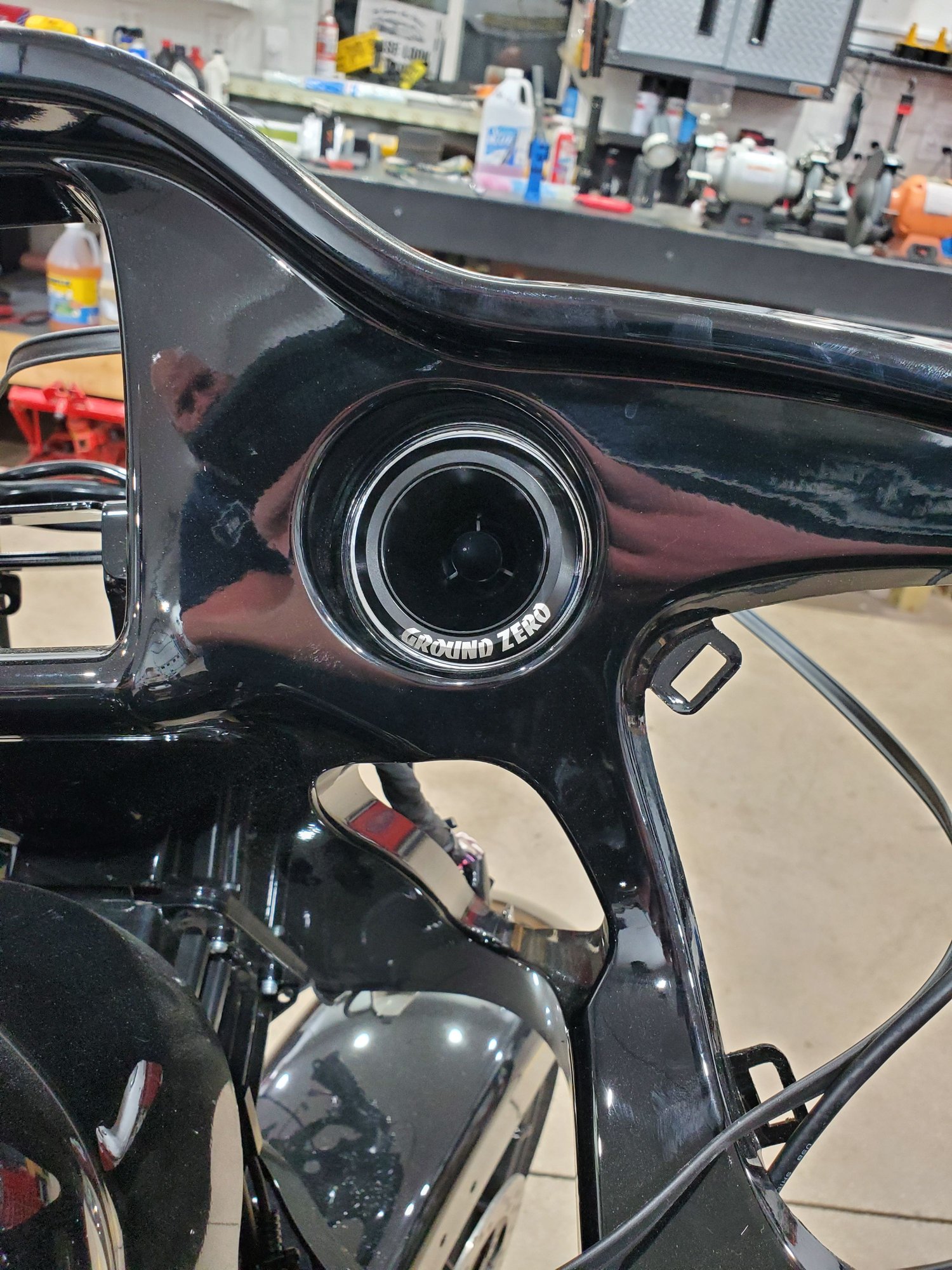

I have a set of metal hog tunes grills that I just drilled a hole in. Just had to make sure the horns are as close to the grill as possible so the speakers don’t it. These are b3 horns, I have bt brackets and prv 6.5s behind the horns
