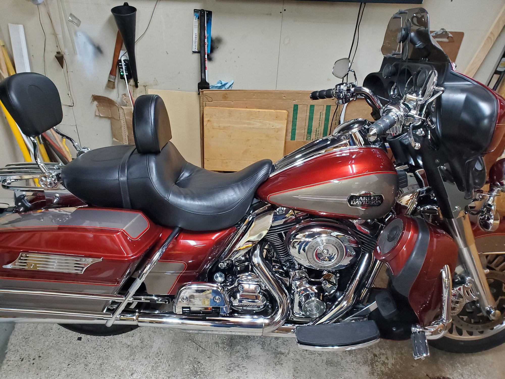

Ah ha! I see your issue since you posted a pic. Those latches you presently have on the bike pretty much suck with speakers in the bags lol. Go back to the original latches. Nice looking bike by the way!
thanks I will try the oems latches and play this particular song and hear any inprovement.
