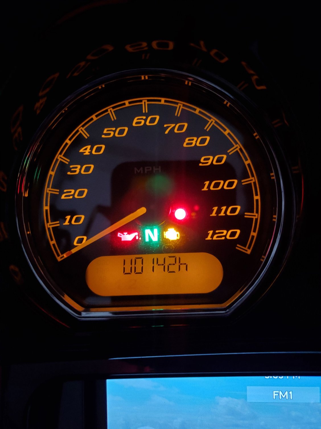

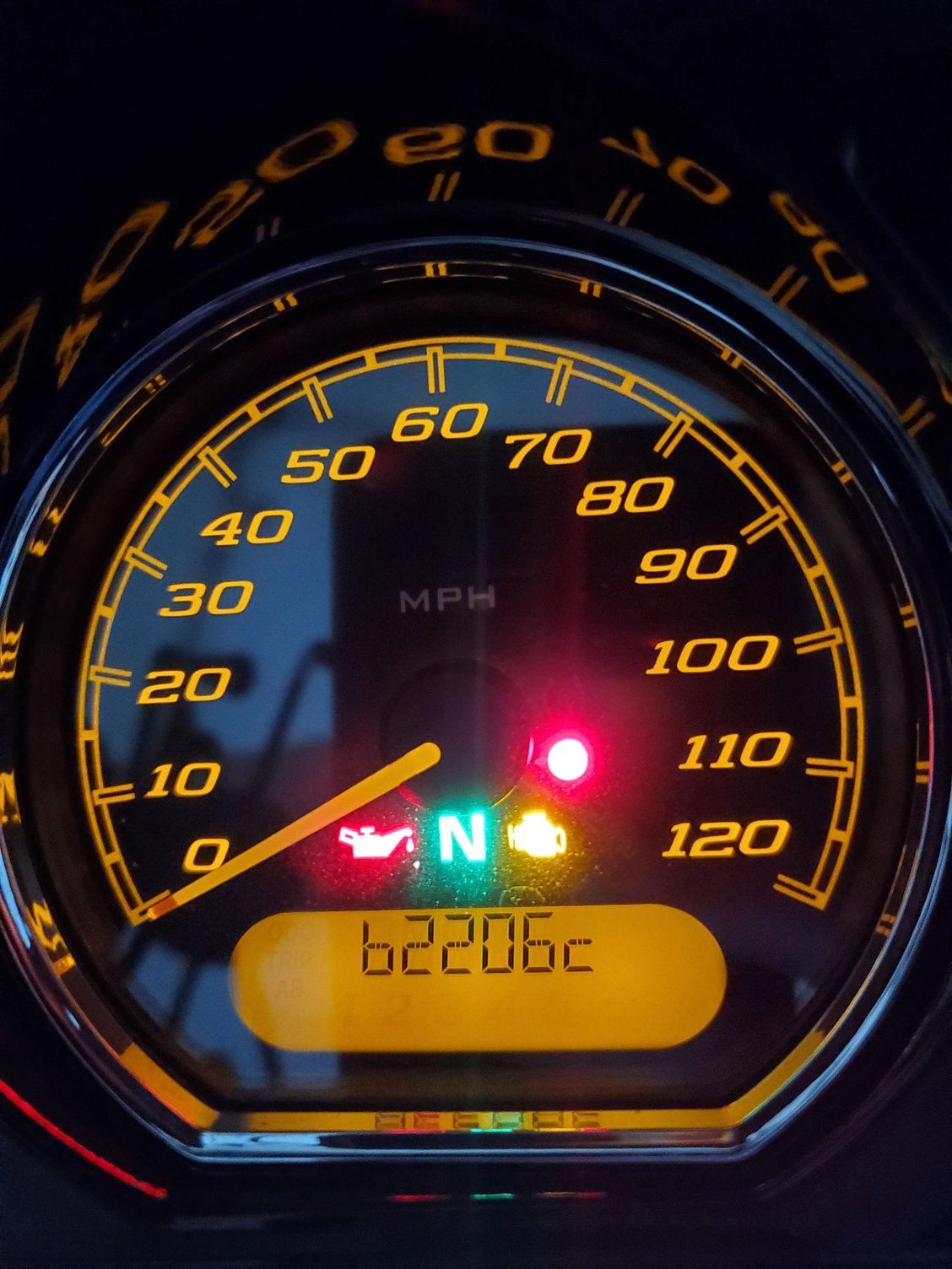

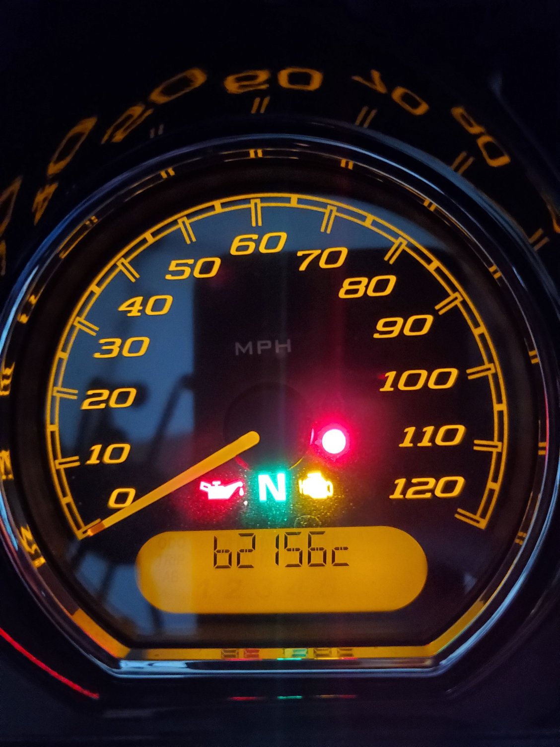

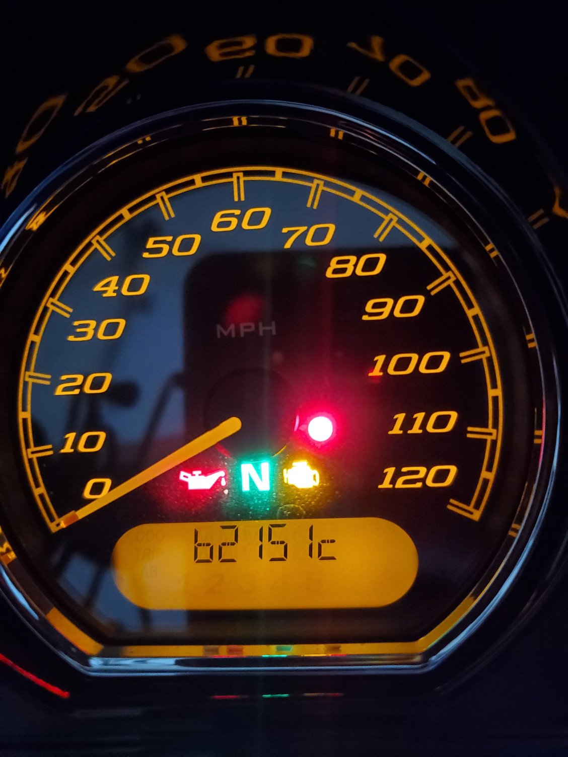

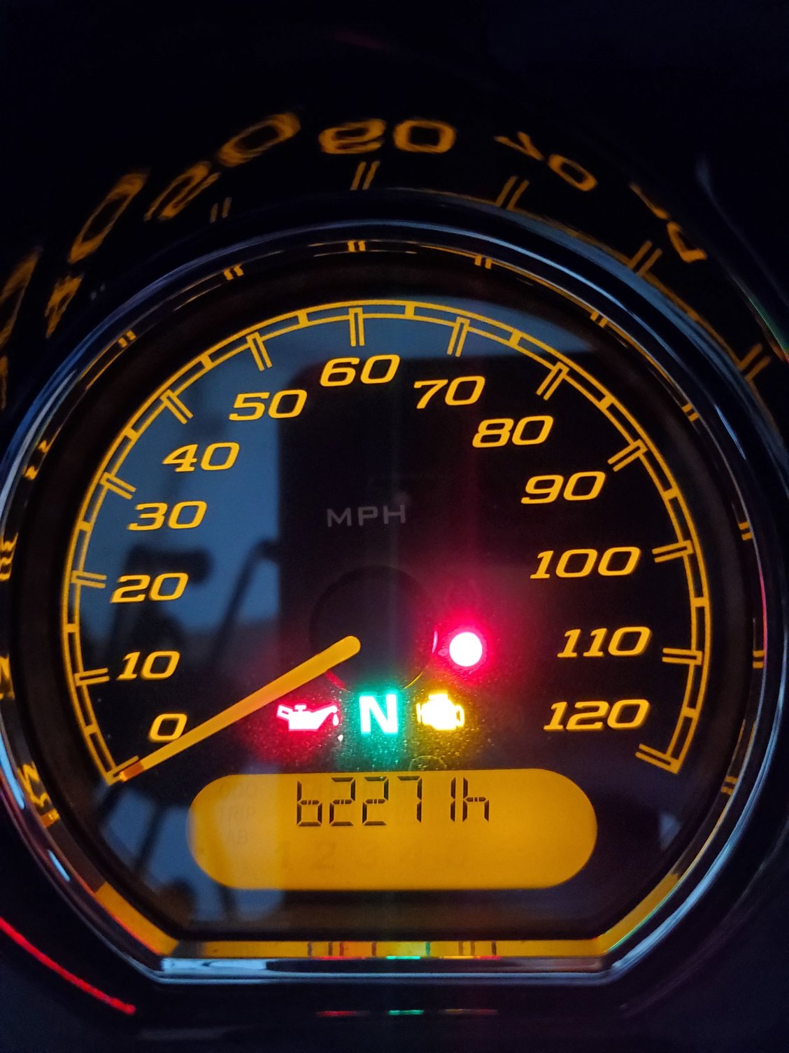

I'll post photos of the codes. I will say that the bike will start on its own now, so the battery itself is charging finally. I googled the codes and some of those b codes look a little scary. Can anyone translate this to see if it is in fact a stator or regulator failure? I appreciate any help in advance.

Have you tried clearing them now that the bike will start? I had the B2206 code on my bike when I swapped handlebars. Actually its still there...and think its a bad wire or crimped wire in the run start switch.
