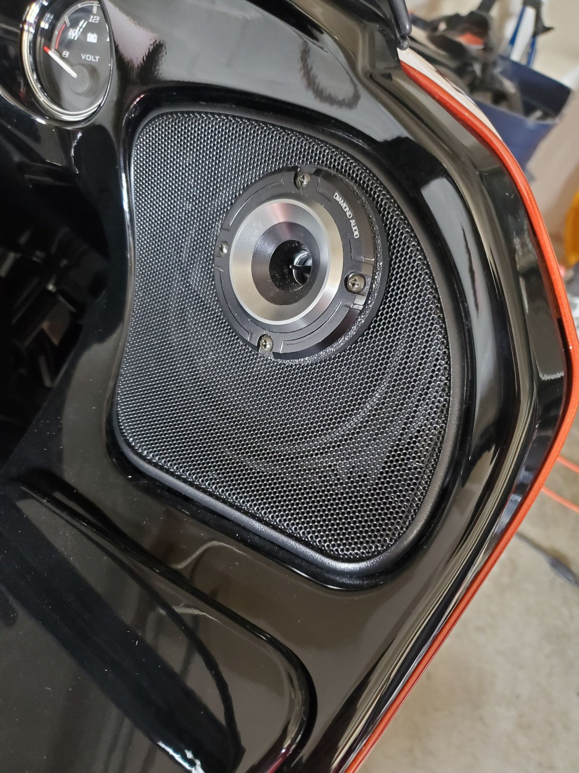

most guys mount tweeters in a gauge hole or in behind the triple tree mounted in the inner fairing. I didnt like either choice so went for the grill mounted option. Mind you, the diamonds just barely fit with a spacer, so not sure other brands would fit at all in the grills.
