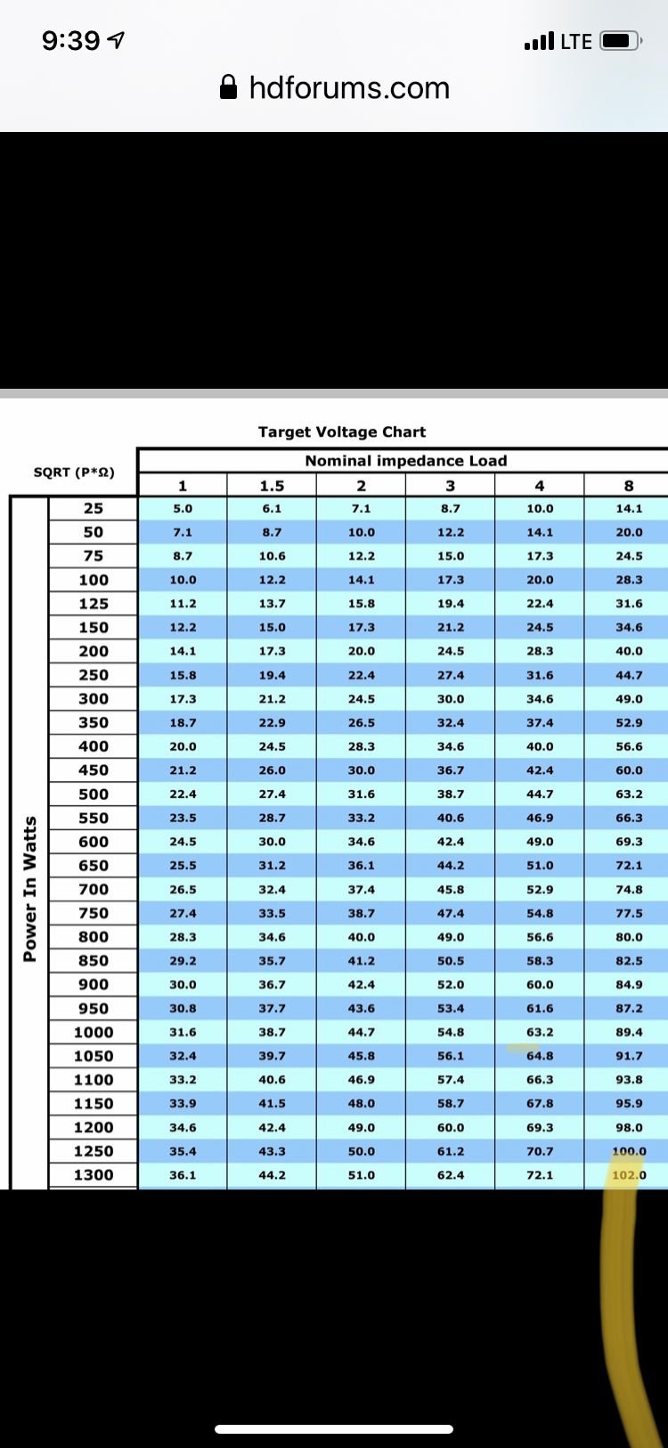

No not running a dsp for two speakers. I plan on using the voltmeter method to match the input/output. I'm just looking for suggestions before I start to tune the amp. Hasnt even been powered up yet
From my calculations I need to set the gain to match 56.56 volts when hooking up my leads to amps output while playing test cd at 1000hrtz.

If I'm reading that correct and what calculators online I'm correct.
800 watts amp power 4 ohms is 56.56

The target volts are for your speakers. not how many watts your amp puts out.
Without a dsp, for those speakers 250 watts is plenty of power.

That is correct and your target volts is 31.6 each speaker.

Yes I was wrong. I needed to take the bridged rms x the 4 ohm speaker. Rms bridged is 400watts x 4 ohms is 1600 and sq root of 1600 is 40.

Brother you can take their comments and run with them if you choose but I'm here to tell you, if you run 400 watts to those speakers, without a DSP you will blow them to hell quick fast and in a hurry!!!! Without a DSP in the mix I would push no more than 250 watts per speaker. This is coming from someone that's not selling you jackshit and has nothing to gain. Carlos knows his **** but he's gonna get a lot of folks in deep water that think they can emulate what he does in his videos. You cannot run that much power to them without a DSP. Period.

Exactly. Not many 6.5" speaker period that can handle 400 watts without a dsp.
