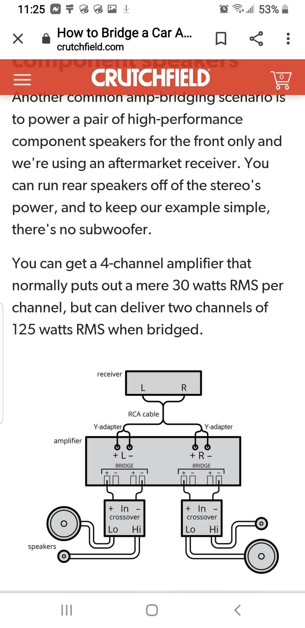

I thought it was either 125 watts per channel or 400 watts bridged per channel. Didnt realize you can dictate how many watts each speaker will get.
Would this be the rca and peaker wire configuration. If so it looks like I need 2 y rca adapters then

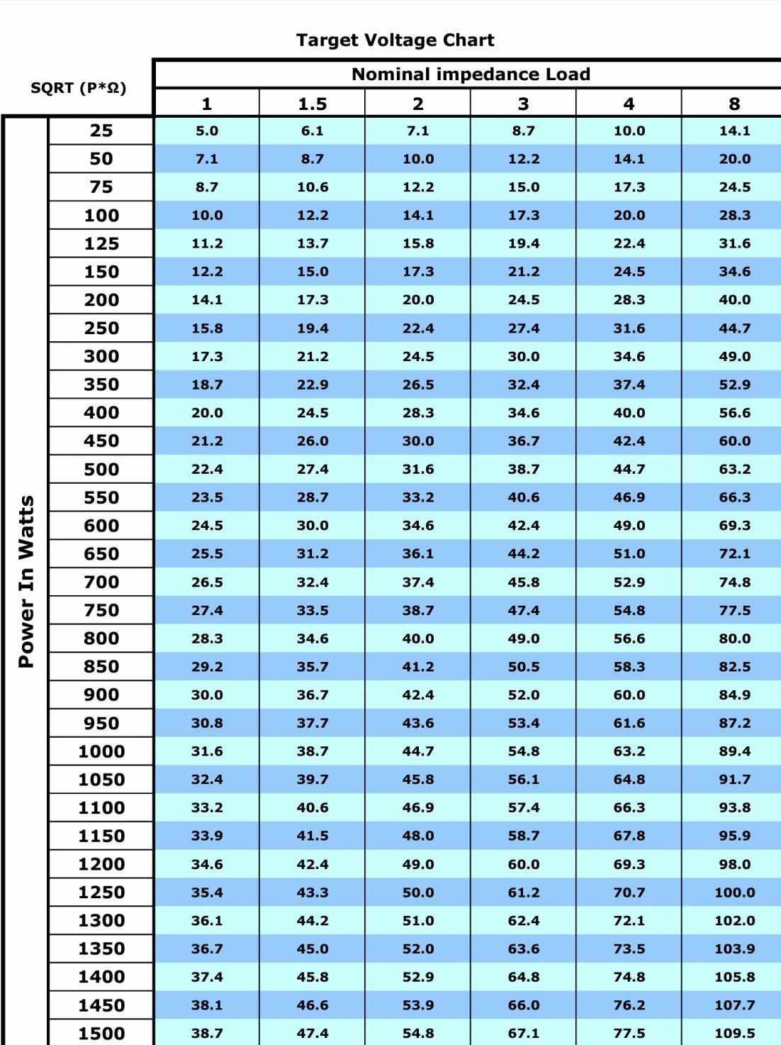

I told you wrong. I was thinking you were using a SMD distortion detector. You need to set your gains using the volt meter to the specs n this chart: Around 23V per channel with the volt meter. Then you can tweek it by ear. Ive been up since 9 am yesterday and my mind is foggy. Sorry for the mis- information.
Yes I used the digital multi metre, and I targeted 23v, to get the 23v which is around 130w I had to turn the gain to almost the maximum, will this cause any damage to the amp or the speakers? I also reduced the master level and te peakers level in my DSR1 almost to the minimum to adjust the sound distortion with my stereo volume turned up to 75%.
