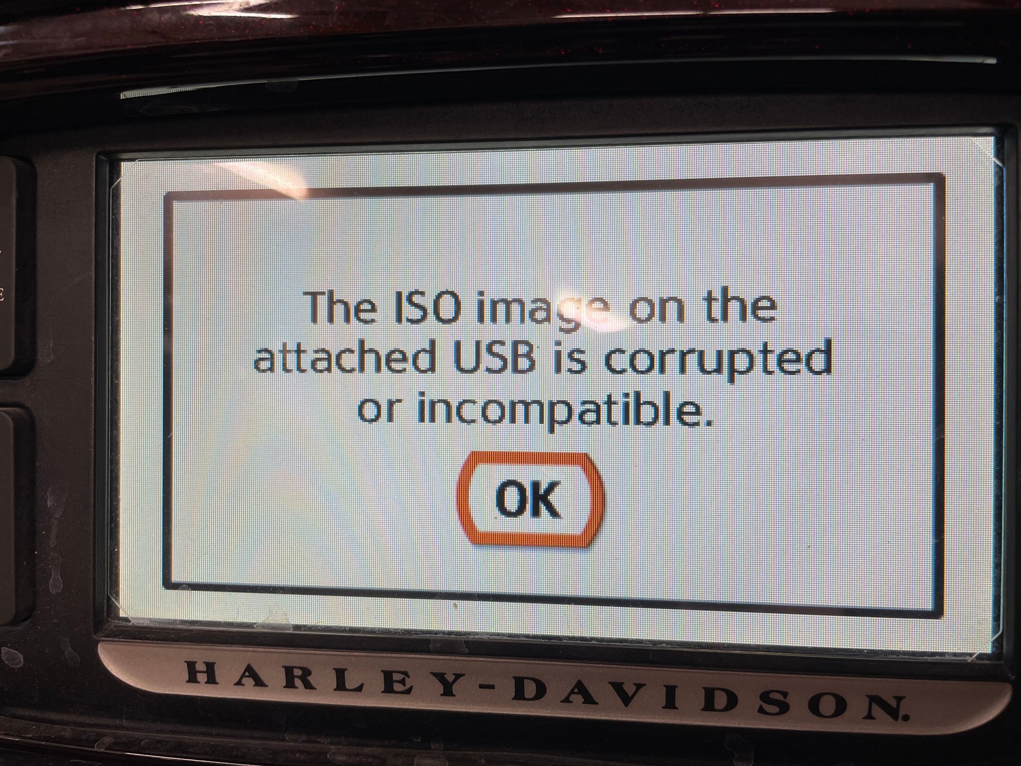

Originally Posted by Notgrownup
When I download the software upgrade to my laptop and open it, it looks like this, 7 files. Am I suppose to save all 7 files to the thumb drive and plug it in? Because I tried that and it reads it like a MP3 drive on my infotainment system.
I've contacted HD support twice. Purchased three new thumb drives. I've followed the instructions to the letter and still get this . Any suggestions?
You extracted the ISO, you can't do that. The raw ISO needs to be the only thing on the drive.
Can you tell me how you fixed this, I keep getting this
