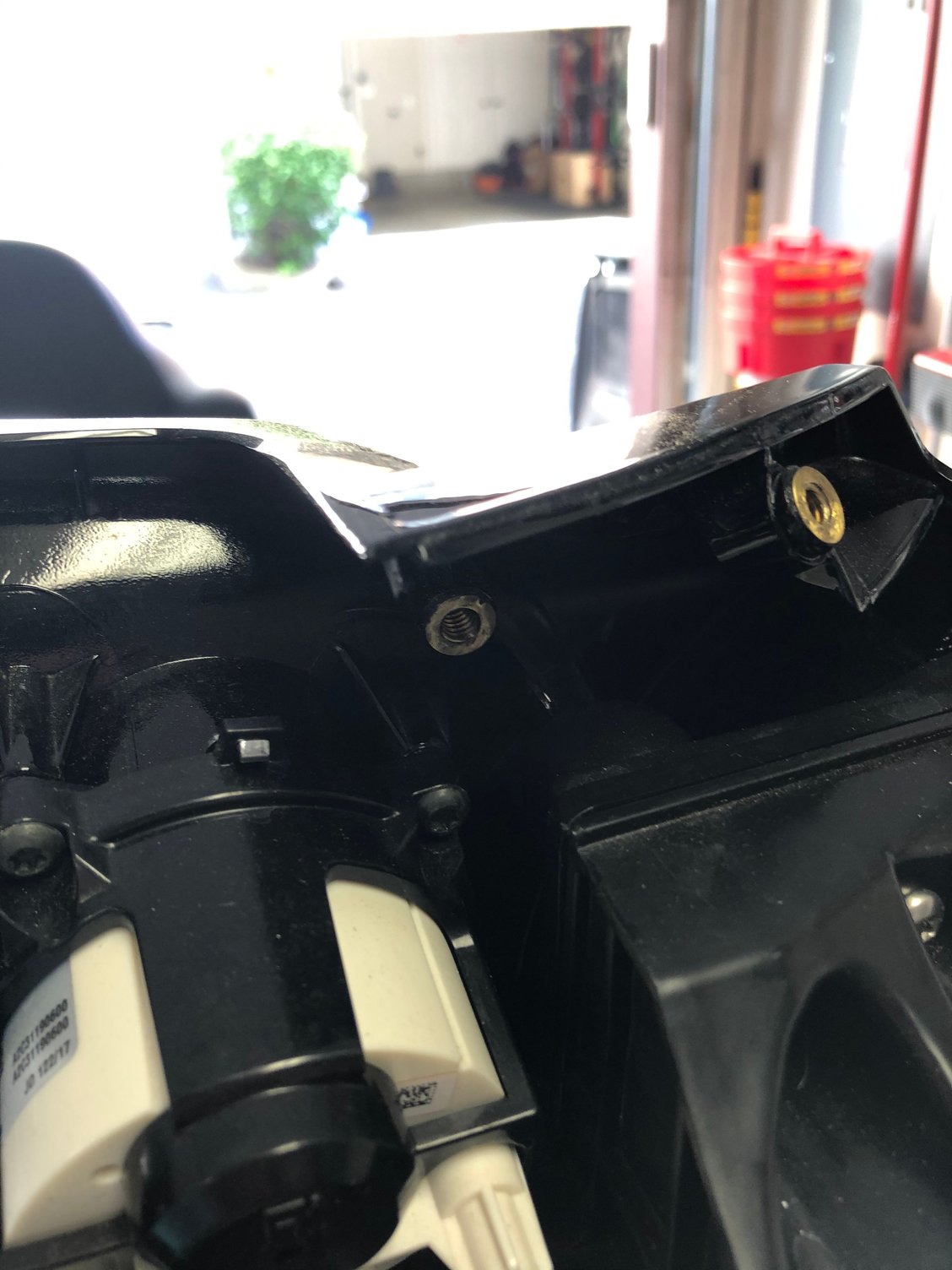

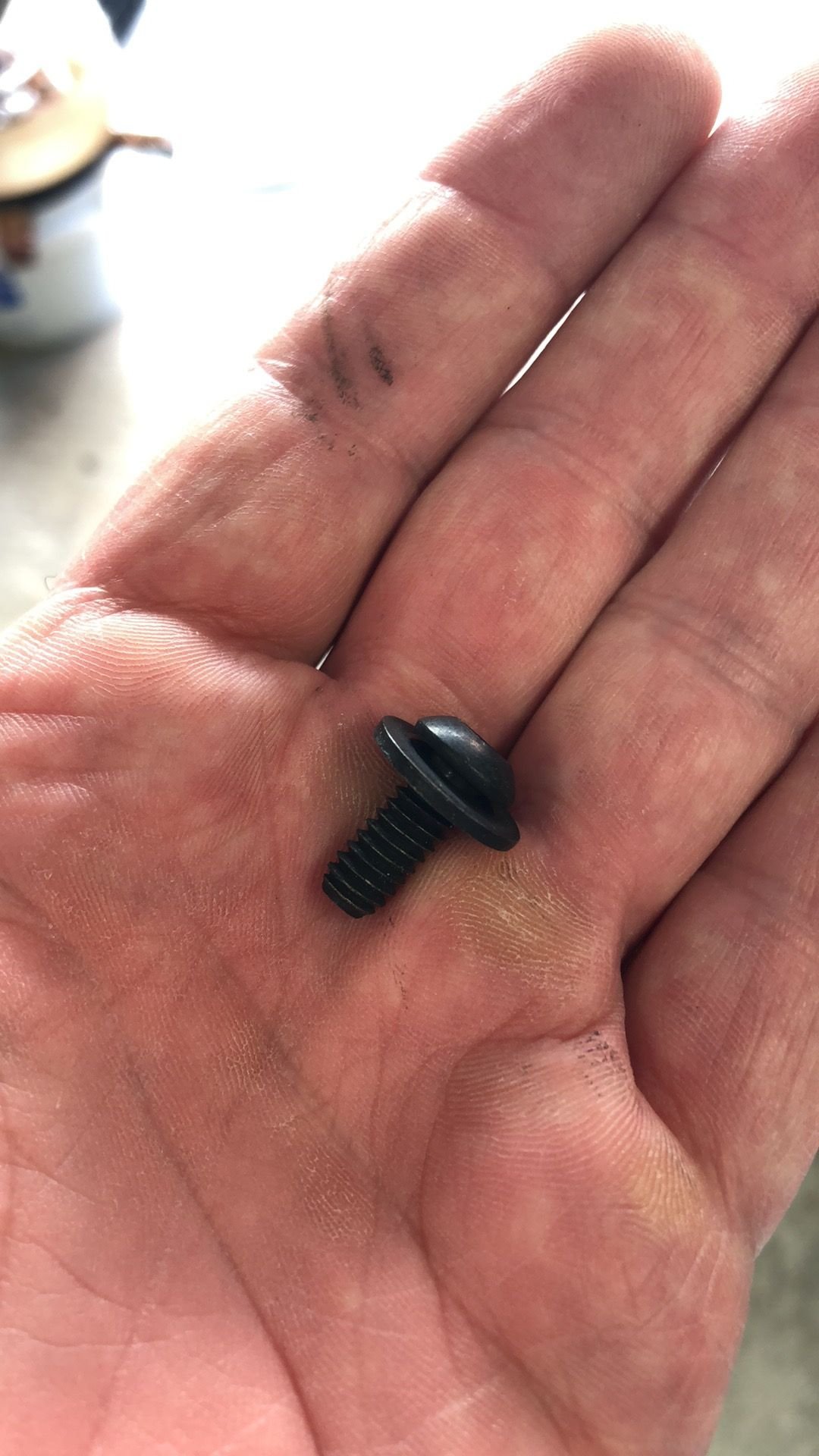

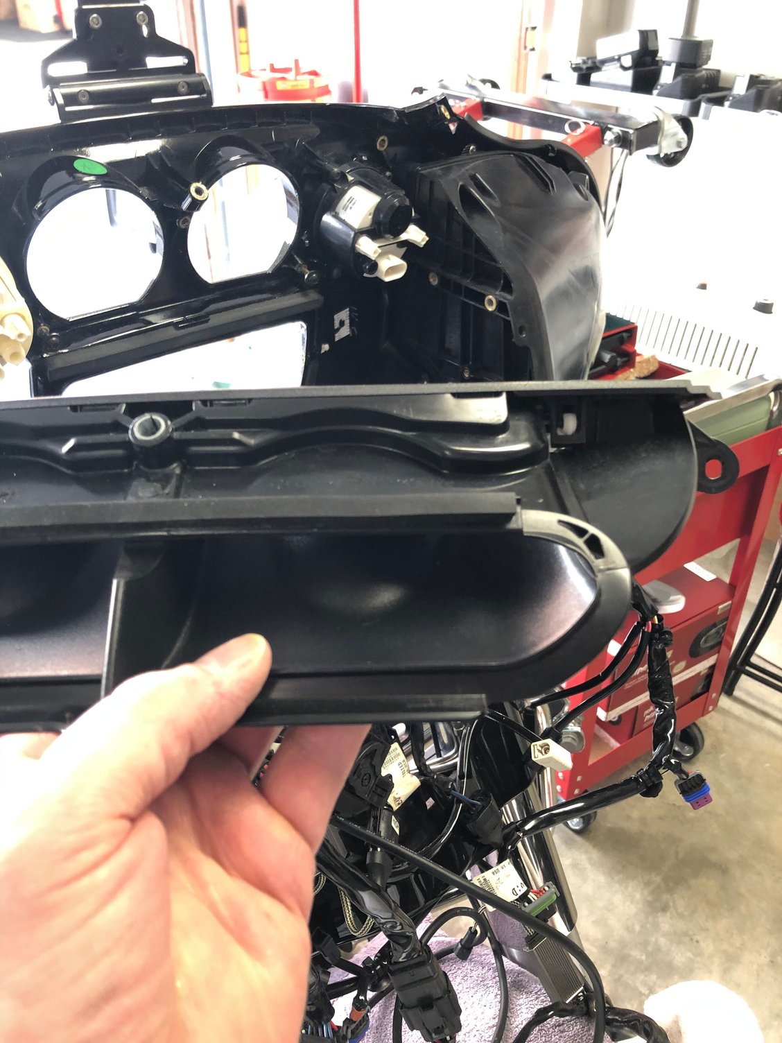

I did a search and could not find this mentioned. I was taking apart the Batwing fairing on 2017 Street Glide. There are 2 black colored torx screws with washers that hold the vent assembly in place. I lost one. If someone knows the name and type of the bolt to help simplify my search for a replacement I would appreciate it. Attached some pictures below.

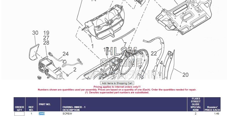

Your part number is highlighted.
the screw is 1/4 - 20, 9/16 inch long
Juice
Thank you very much!
