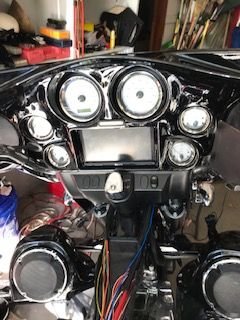

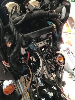

To me it remained about the same.. The way the Sony was designed, it mounted high so the gauges above were up taller than stock,and the room was under. I ended up mounting the Stinger under and the dsp on the left. I was going to mount the second RF 400 next to the right speaker, but it was too big so i stuck it in the pac. I will look back and see if I can find a few pics
Old May 25, 2021 | 01:09 PM
mcdc1224's Avatar
mcdc1224
Joined: Feb 2011
Posts: 671
Likes: 109
From: North Myrtle Beach SC
SB, here is a pic....not that great of one..... but there is a small amount of room above the HU also
