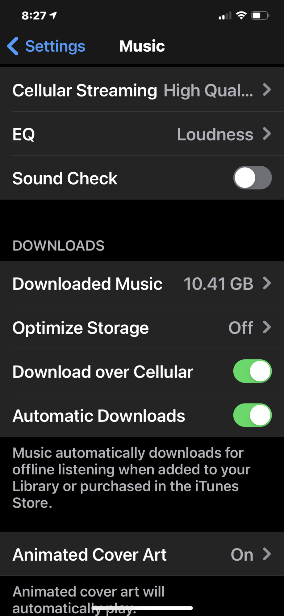

good morning, I have been reading and reading and trying to make up my mind in which way to go as it is nerve wracking process for me when it comes to Audio equipment of any kind. I have a 2009 HD FLHTC and I have replaced the factory stereo with an Aquatic Aq-MP-5BTH because while my bike was getting some over the winter service I heard this Aquatic unit in another customers bike and it sounded really good in the shop on the table and thought to myself that's pretty good as it is Bluetooth also and that means no more wires hanging from my IPOD to the handlebars, clean looking and powerful to boot. Now that was with Hogtunes speakers and I have Infinity Kappa's six and a half inch in the fairing, thinking that should be pretty good. Not so. For some reason the audio output of the IPOD is like half of what it used to be with the old head unit and that's with me running the volume to just about full volume before distortion is ruining my day. Yet if I were to listen to Fm radio it is plenty loud but really has no soul and no joy listening to that. I enjoy Jazz, Album oriented rock like pink floyd, the stones, supertramp and the like. No country but like Willie Nelson. Blues is good and I'm cool with that. Now here is where I need to ask who is running the Kappa's with what Amps and do you think that would be a good way to go as I am thinking of picking up the Aquatic AV 300 watt 2 ohm Amp or should I look elsewhere? Has there been any problems out there with what I am running at the moment? Sorry this is so long but that is the only way to get my thoughts out.
i can solve this somewhat for you if I’m assuming correctly that you’re using Bluetooth to connect your iPod…
On the iPod tap settings… scroll down to music be tap on it then scroll down til you see sound check… MAKE SURE THAT IS UNCHECKED… check volume levels on iPod and bobs your uncle…
