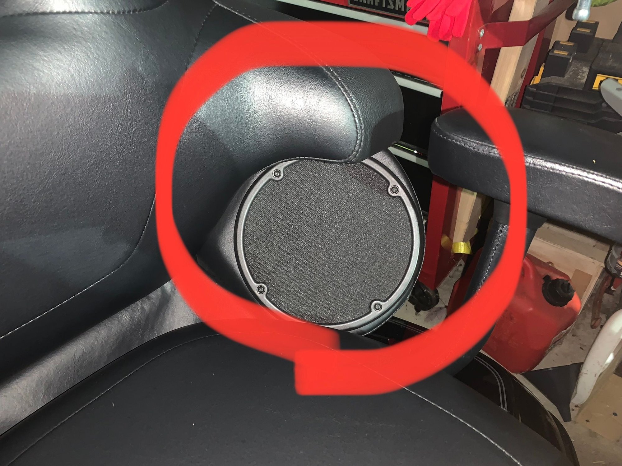

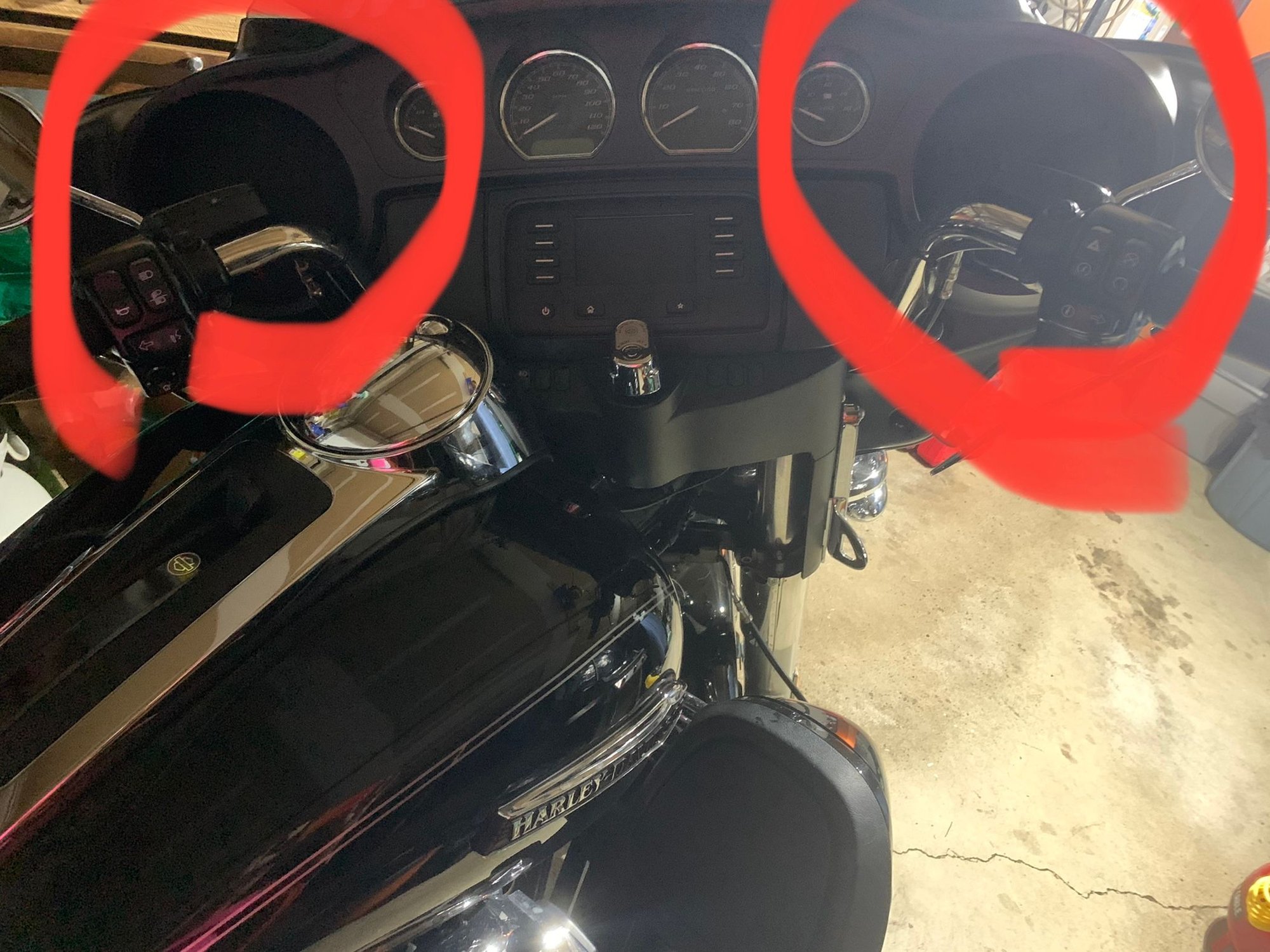

We have a 2016 Electra Glide Ultra Classic and are looking to replace all four speakers. Any suggestions as to what to buy and is it something we can do on our own or will we need to bring it to the dealer? Hopefully I posted in the correct spot. Thanks!
Two front. I wasn’t sure if they all look the same so I took pictures.

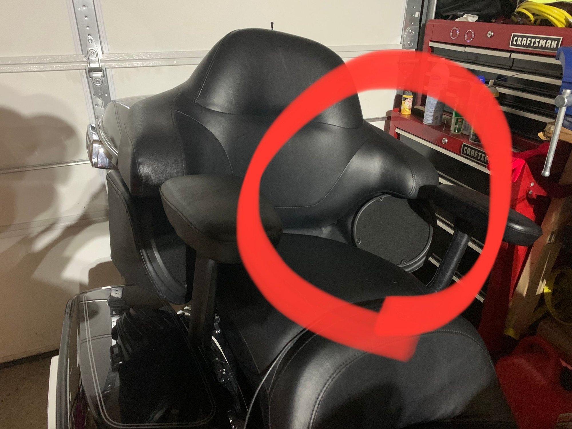

Two rear
Just another rear shot.
