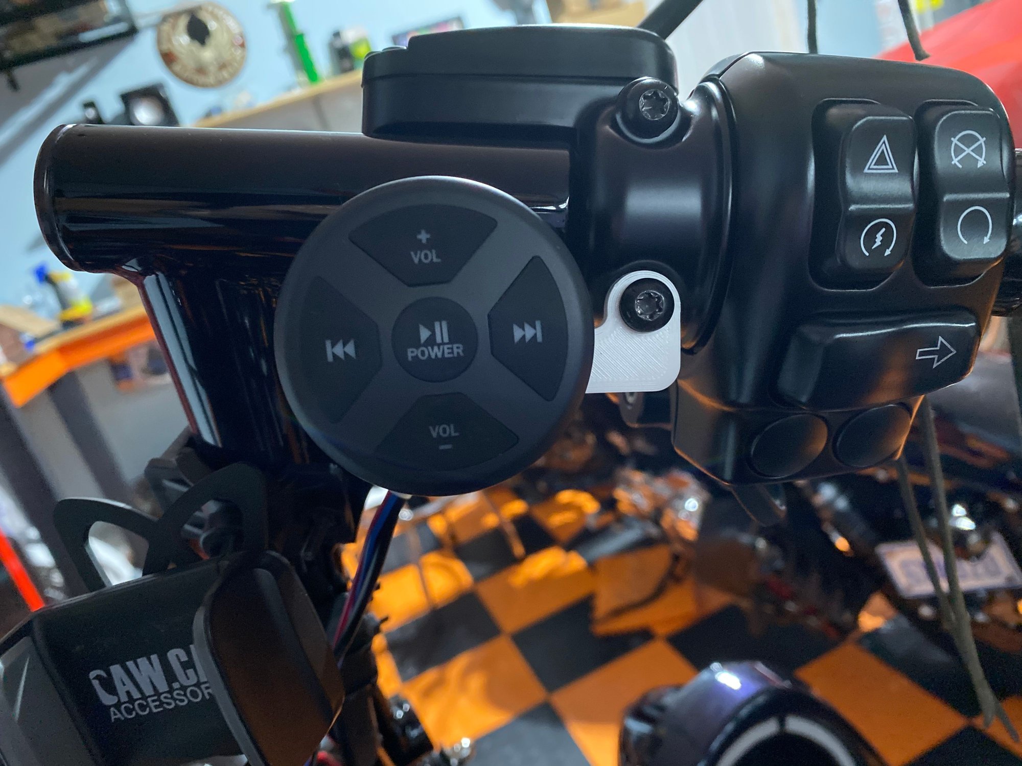

I've seen stuff like you described advertised before but never tried them. MTX makes one that has a power on lead for amplifiers that might be useful to you.
UNIVERSAL BLUETOOTH RECEIVER AND REMOTE CONTROL

MTX is what I’m using with the Rockford amp. Bottom pic shows the mock-up bracket that I made out of aluminum later (can see it in the upper pic)
