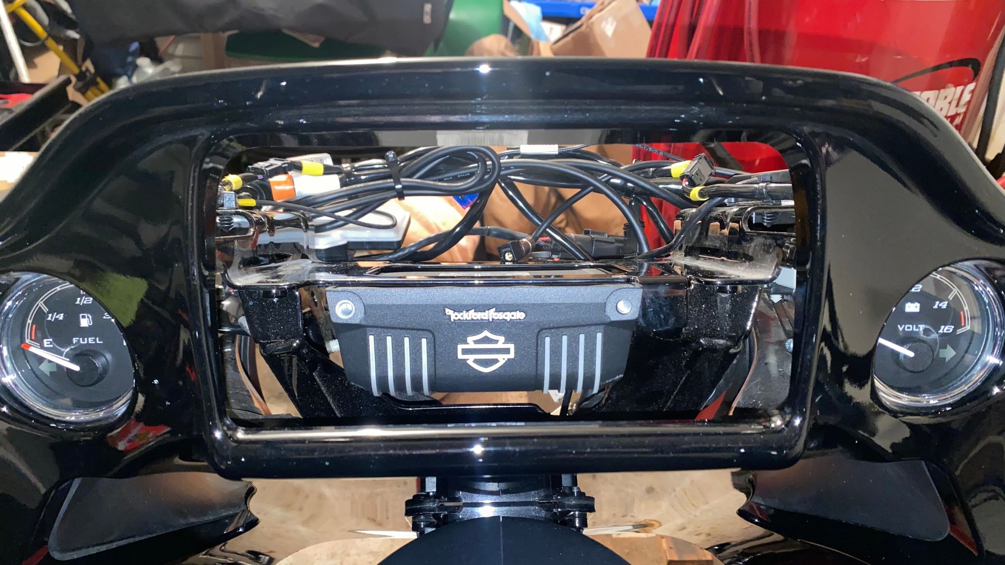

I just had the RF amp and speakers added to my Street Glide (I have Sony 7000 HU). Amp went into fairing via their kit, wiring came for plug and play, and mine already had 4 speaker wiring from HD installed, so that part wasn’t involved. Only had to run power for the amp. Running the two fairing speakers and two in bag lids off the amp. Don’t know if that helps with what you’re looking for or not.

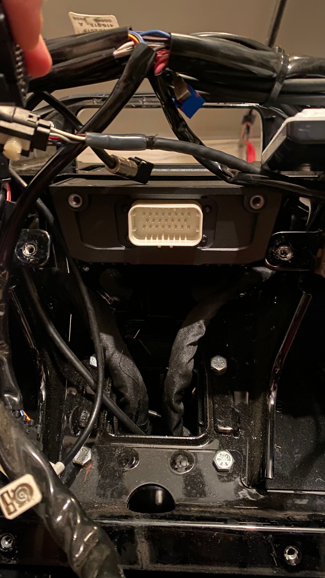

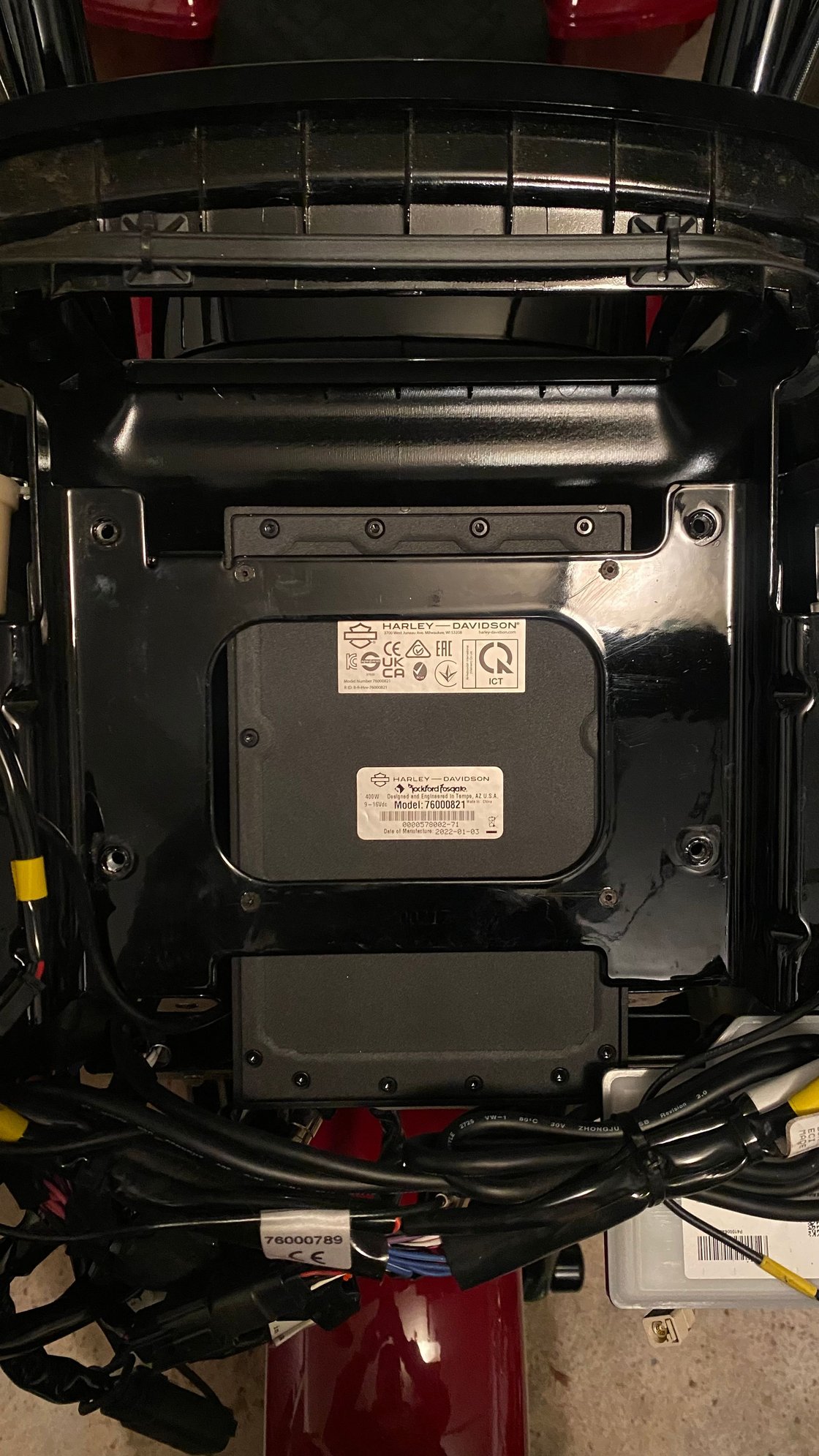

Just finished the install on my 2021 RGS last night. I did the Harley powered by Rockford Stage 2 fairing speakers and amp only. Had to custom mount the amp under the radio, I removed the big connector block that gets mounted in the side of the bag. Depinned the plugs, and bought new molex connectors to put on the wire. Extended the power and ground wire so it could reach down to the battery. For my bike, with the bluetooth dongle, this also had to be mounted under the right side cover below the seat. Had to pull 2 canbus connectors out of the amp wiring harness and route them from the fairing down to by the battery. Everything worked great, and no amp tanking up space in my saddle bag.
