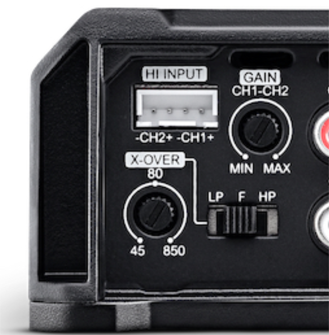

From what I have been reading daily, my 400.4 bridged will be a good amount of power to help these suckers bang. With the O-scope and a - 5db 1khz test tone, I'm confident I'll get them to a comfortable level without over excursion.
Now if only I can get the hpf to work on the evox. Talk about a WIDE band from 80 to 850hz. How the heck would I locate 100 or 120-150hz...
My Kenwood headunit has a 80hz - 120hz - 160hz & 240hz built in xover. I wonder if it would be better to set the preouts for the GZ on my deck to 80hz and set the amp to Full Pass.
