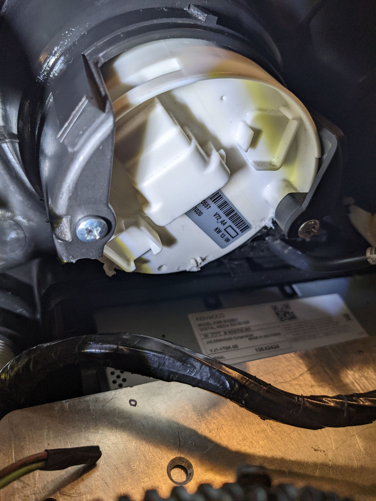

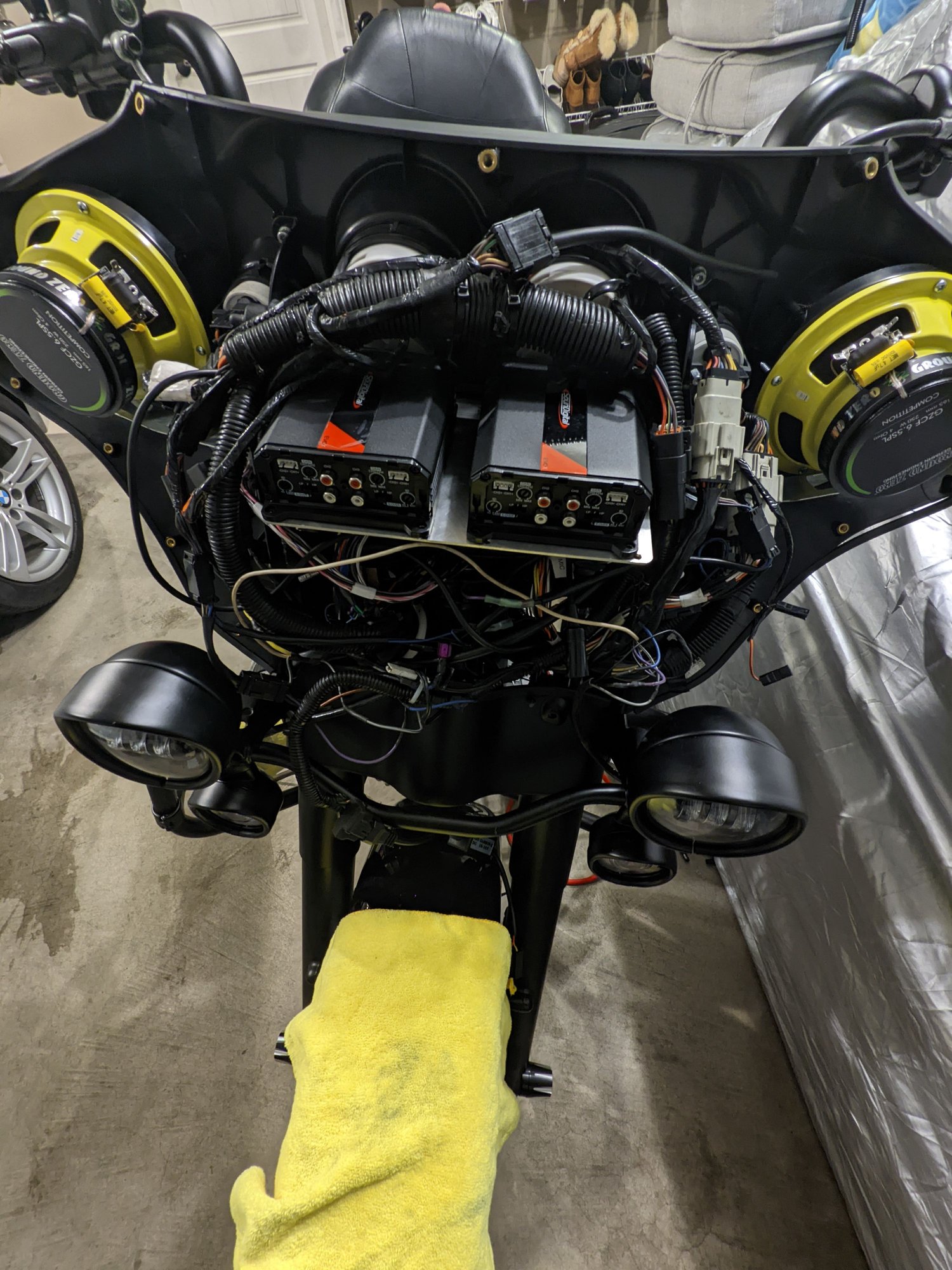

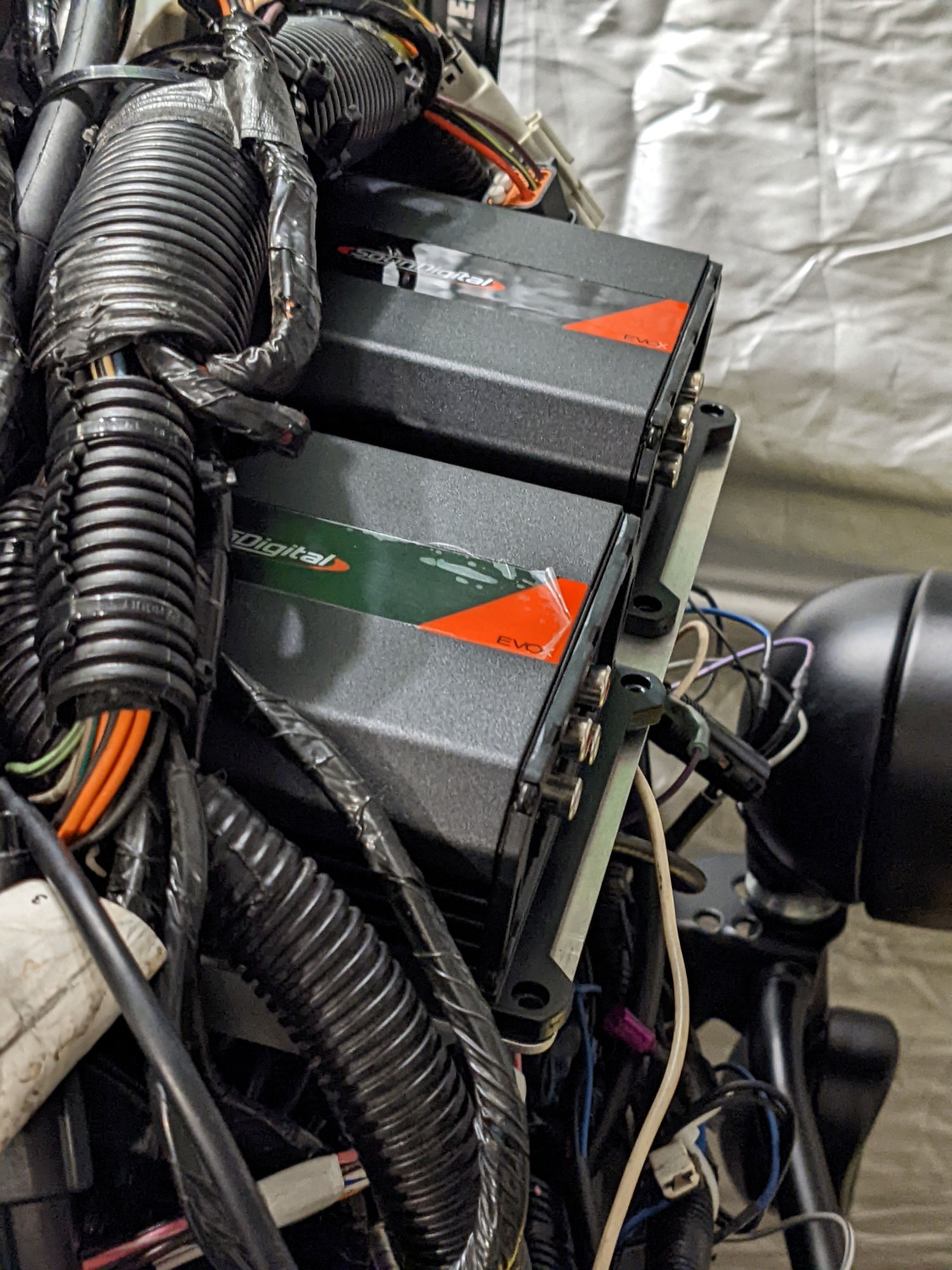

09 Ultra Classic w/ batwing fairing. Trying to squeeze 2 800.4's on a Kustom Cycle L amplifier rack. Took the amps out and could bolt up the fairing...i can feel the fairing bumping the edge of the amps when trying to attach it to the inner fairing.
Has anyone successful mounted 2 in the fairing?

I searched & searched. I removed the AM/FM antenna (never use radio) and moved the tray in a little further and tilted it all the way down. The amps slide right to the back and touch the black trim on the big guages...I think I may have to trim the black off with a dremel and slide them back even more.
My inner fairing was removed and the shop installed a new one and did a horrible job with the wiring...it's a mess in there...this install is off to a horrible start!

I have 2 of the 800.4 mounted on a j&m amp tray. You gonna need to trim the back of the gauges and slide the amps back as much as possible. I used velcro on the tray to get the amps mounted as far back on the tray as possible.

So the back of the gauges...meaning the black mounting tabs that stick out or the gauges themselves? From what I can see, the tabs are what the amps hit when pushing them back.

just try trimming the tabs first then see if everything fits. If not work on the gauges next.

a dremel and test fit will make short work of fitting them.

It worked...dremel and some careful planning and got the amps far back tucked under the gauges.
