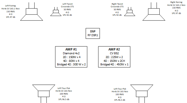

Please see attached diagram.
How would you wire these two amps to these 6 speakers? Thanks in advance for your thoughts.

B52 to 165 in fairing
Diamond 1/2 to Tour Pack and 4/3 to tweets
