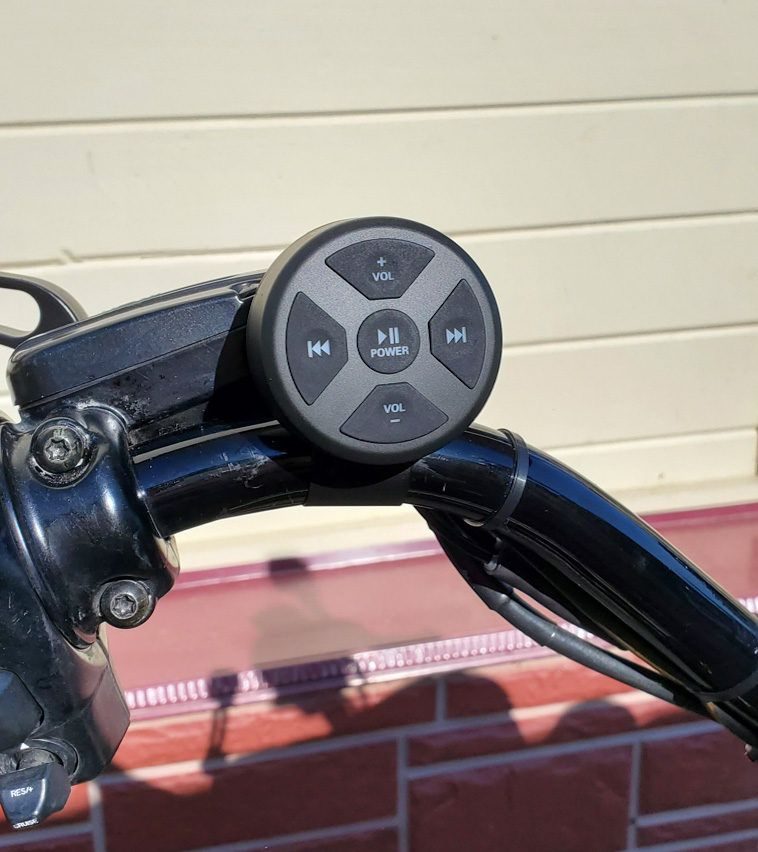

MTX MUDBTRC
great sound! i'm using it on all RK installs
