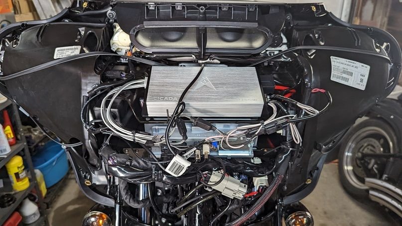

I just finished installing my DSP 150. I am still in the process of setting it up. Damn,.. I feel dumb !
Other than that, I have not gotten far enough to hear noise. My only problem with it is, the power lug. For me, I think that should have been installed @ the factory. I'm not sure how far it is supposed to go in. I can't get it in any farther and judging other amps that I have, they ALL look like the block butts up against the face plate. I also don't like the design of the block. Every amp I have ever seen has the screws for securing the power and ground cables either on top or in front. I actually thought it was made wrong. I emailed Cicada tech support. They told me it was designed this way. FWIW,.. once you install the block into the amp, you can not get an allen wrench in there to tighten the set screws ! I had to tape shut all the vents/holes and anything that looked like it could let dirt in or out. Then I took a little dremel to grind little eyebrows on the mounting foot, until I could get an allen wrench on the screw ! 2 things are for CERTAIN. 1) You better disconnect the power cable from the battery BEFORE trying to check the tightness on these screws ! You surely would arc the wrench against the mtg. foot. 2) You cannot even get a wrench on the screws when the amp is installed ! So, see rule 1.

Trying to get the connecter block out of the amp can be a little challenging but not too bad, at least it is for me. I used the Cicada wiring kit and didn't have any issues with power or ground wires, is that the kit you're using?

I use those amps and have NEVER had an issue with the power supply plug. Never had to grind on the amp chassis as the design is to be assembled before plugging in.
The higher end JL HD series amps use a similar power plug and have been for years without any issues.
Sealing off the ventilation holes with tape is going to cause the amp to run hot and possibly fail prematurely.

Since I apparently didn't list every step for this procedure, Here's the one step that should have been obvious. After the grinding was completed, ALL the tape was removed before installing in the bike.
Using same kit. But never had an amp where the block wasn't already installed in the amp. The block is pretty tight in there. Don't really want to try to take it out. Nice and tight and don't want it to start to loosen up from in and out. Probably be ok but, that's just me.
