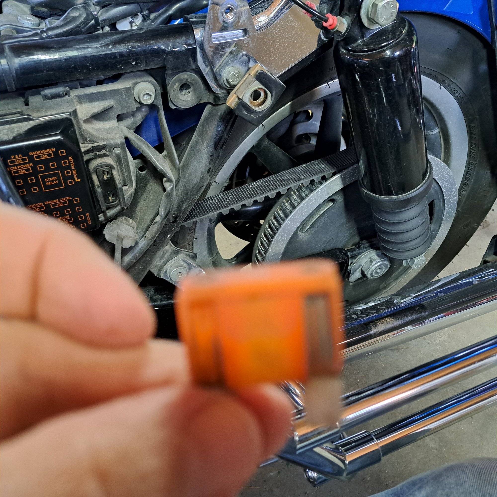

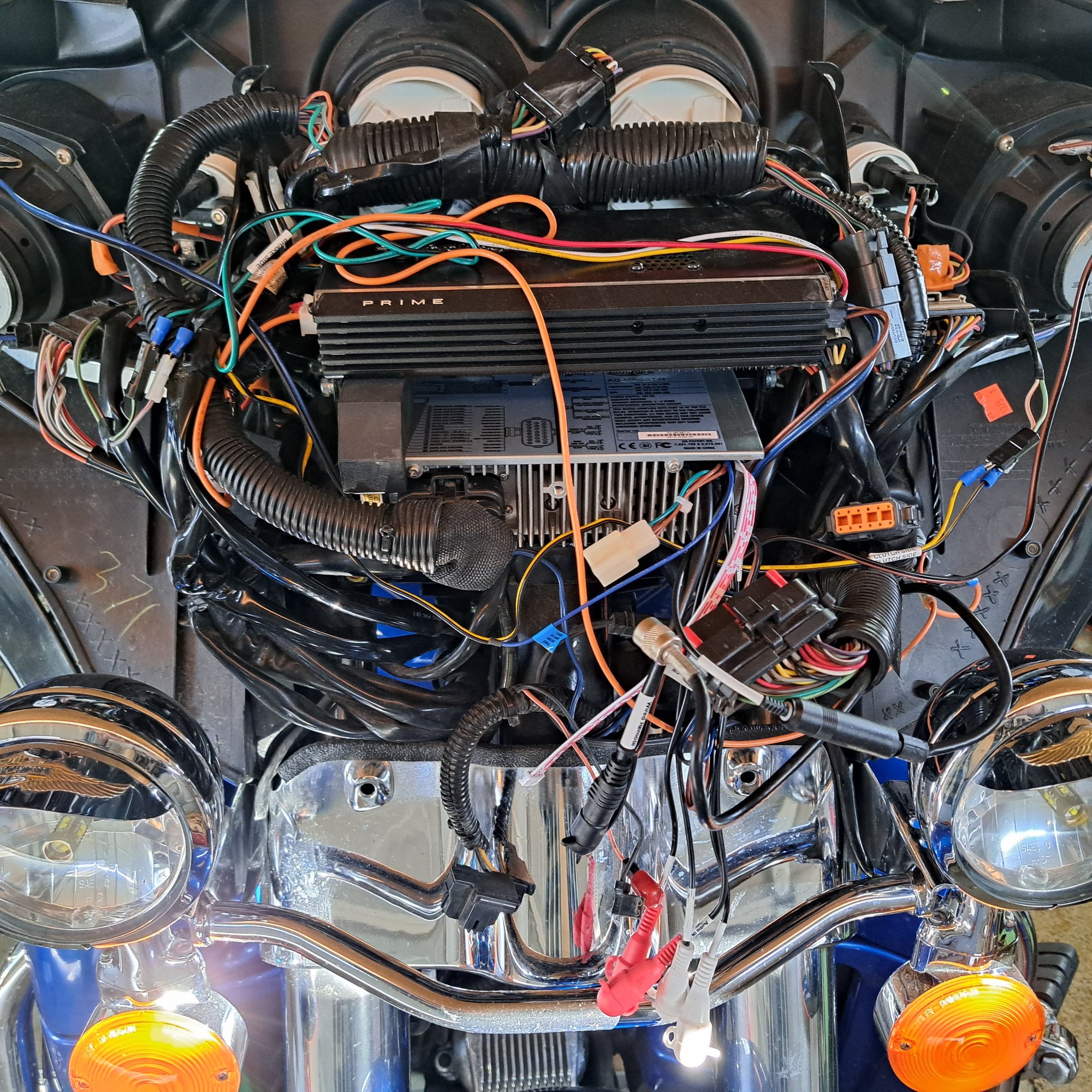

If you did not disconnect the battery before install, check the fuse block, and corresponding fuses. Left side I believe. Can you send a picture of the back of your new radio how you installed it?

I checked the main fuse it's good, 12 amp on the volt meter. The radio and the lights for the speedo and tack lights work, I get the mileage and thats it. The radio is a plug and play.
Stereo on and speedo and tach .

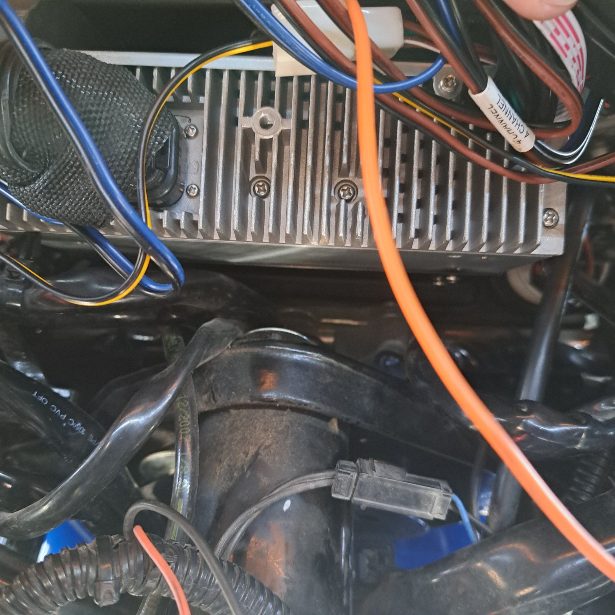

5th picture down, that big plug looks lonely. You also did not mention you had an amp? Did you hook up both trigger wires?
