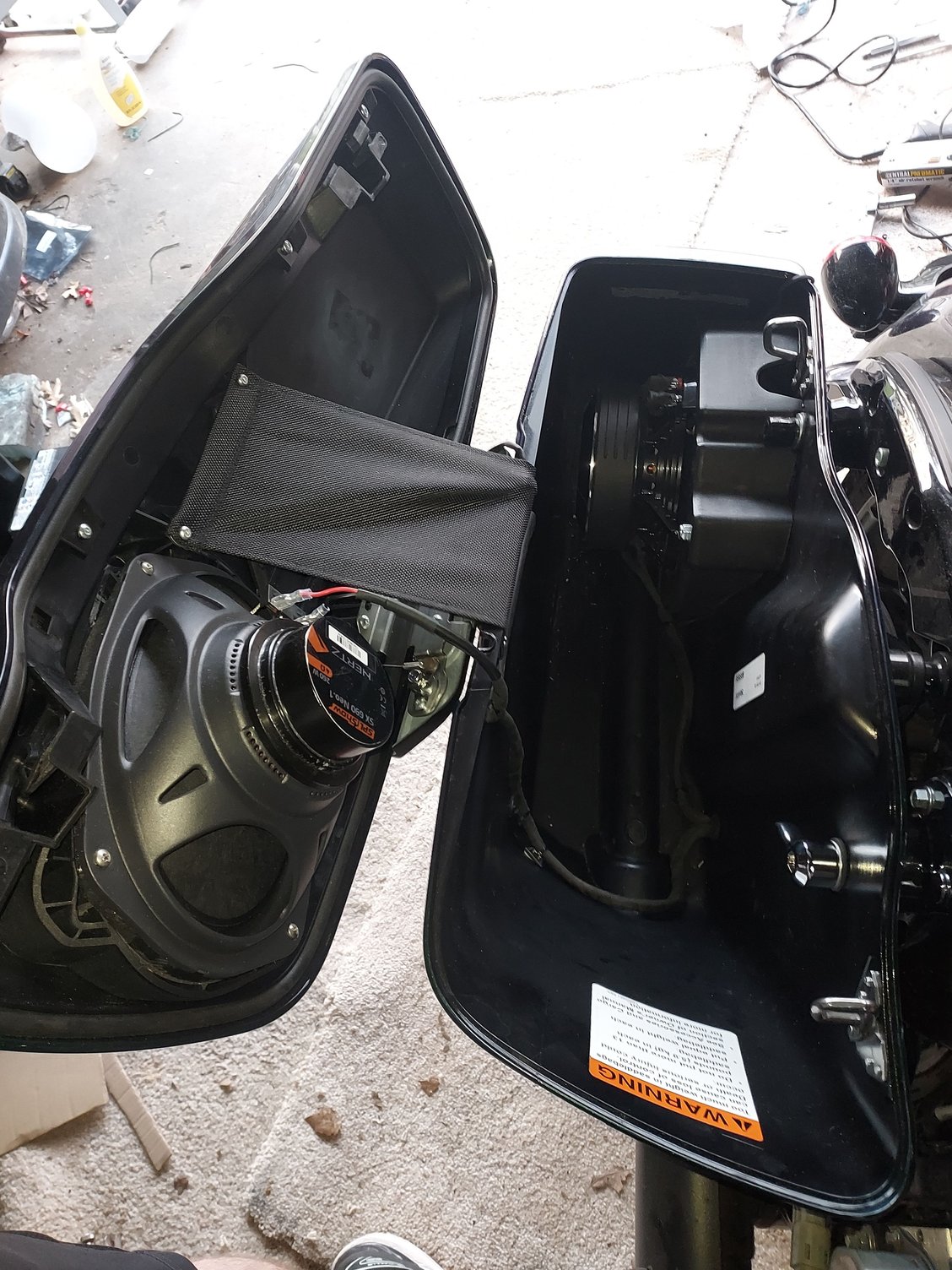

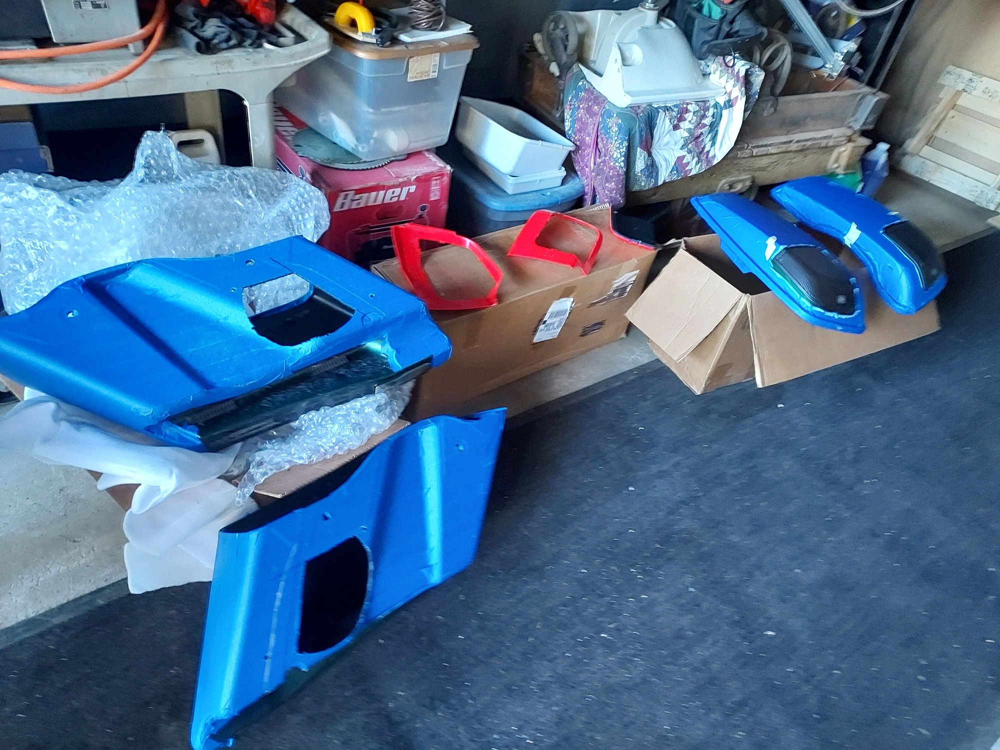

i designed in CAD and 3D printed my own amp rack to fit 2 sound digital EVO X2 800.4's in my fairing... might tweak the design to work with other amp combos as well. working on a DSP bracket now.
I went with the Nagy rear sub rings for 8's. i think it turned out pretty well for being a newb. when i cut the second ring, it turned out better than the first because i learned from mistakes i made on the first one. theres a couple youtube videos on installing sub rings. they have mid bass driver rings and sub rings so just make sure you get the correct ring. i might end up sealing my bags and/or fiberglassing them or putting in mid bass drivers if i dont like how it sounds. kind of a trial and error type thing.
