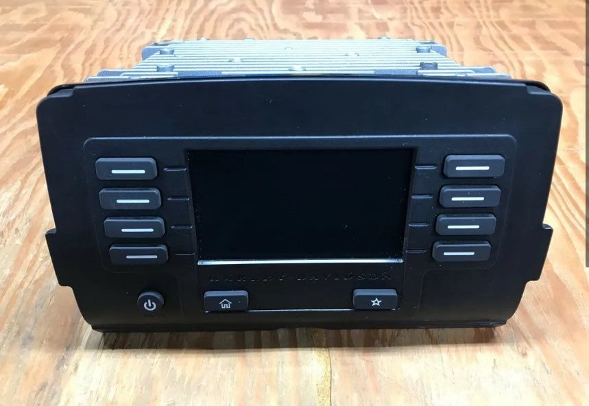

These two guys are giving you solid advise... something weird has happened... HD dealers are sometimes quick to say things like you are being told, whereas an audio guy might be able to fix the issue for a simple programming fee.
BTW, that bike did not come with the Boom! GTS (like AkaReaper said), that head unit did not come out until on the 2019 bikes. That bike probably had the Boom! GT 6.5 from the factory. If it now has the Boom! GTS in it, then somebody has upgraded the head unit (I did it to my last bike, a 2016 RGU). Just for reference, for when/if you're talking to somebody local about looking at the head unit >>>
Boom! GT 6.5
Boom! GTS
