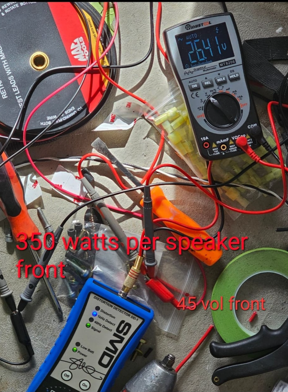

Thanks. Had a fellow member on here respond...he took readings off his EX4 with a DD1 - got around 26V

I see somebody sent you a test of the EX4, 26 volts should have you sitting around the 175 watt range at 4 ohm.
