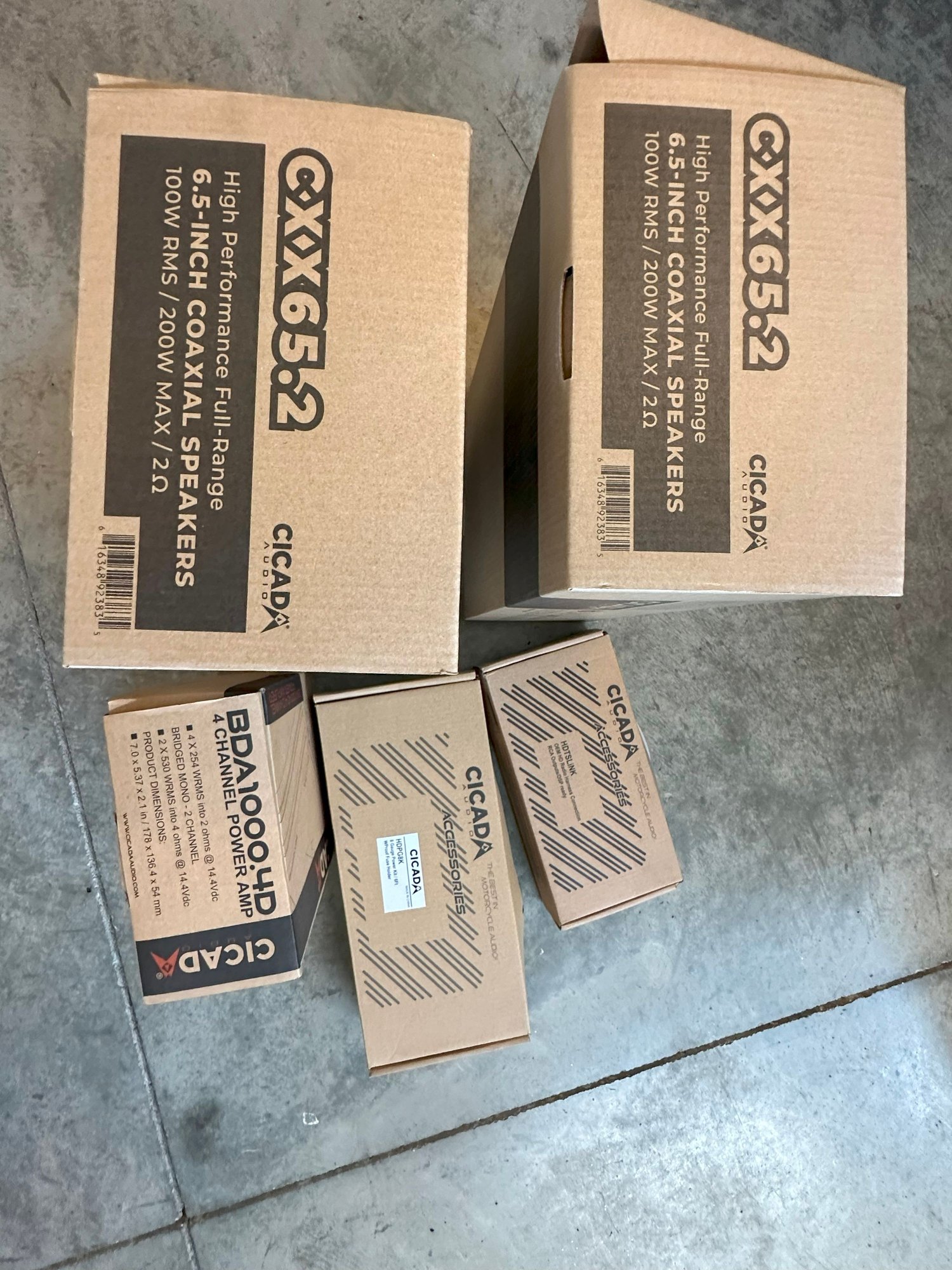

I run the cicada CXX65.2 in my fairing and tourpak with a BDA1000.4 pushing them on my Triglide (no lids for 6x9s).
It is extremely loud and clear with the gain only at about 25% still using the stock GTS head unit.
I recommend buying the wiring harness and fused power wires from them as it makes the installtion a piece of cake.
Awesome upgrade from the Boom stage I amp and speakers that came on the bike.
