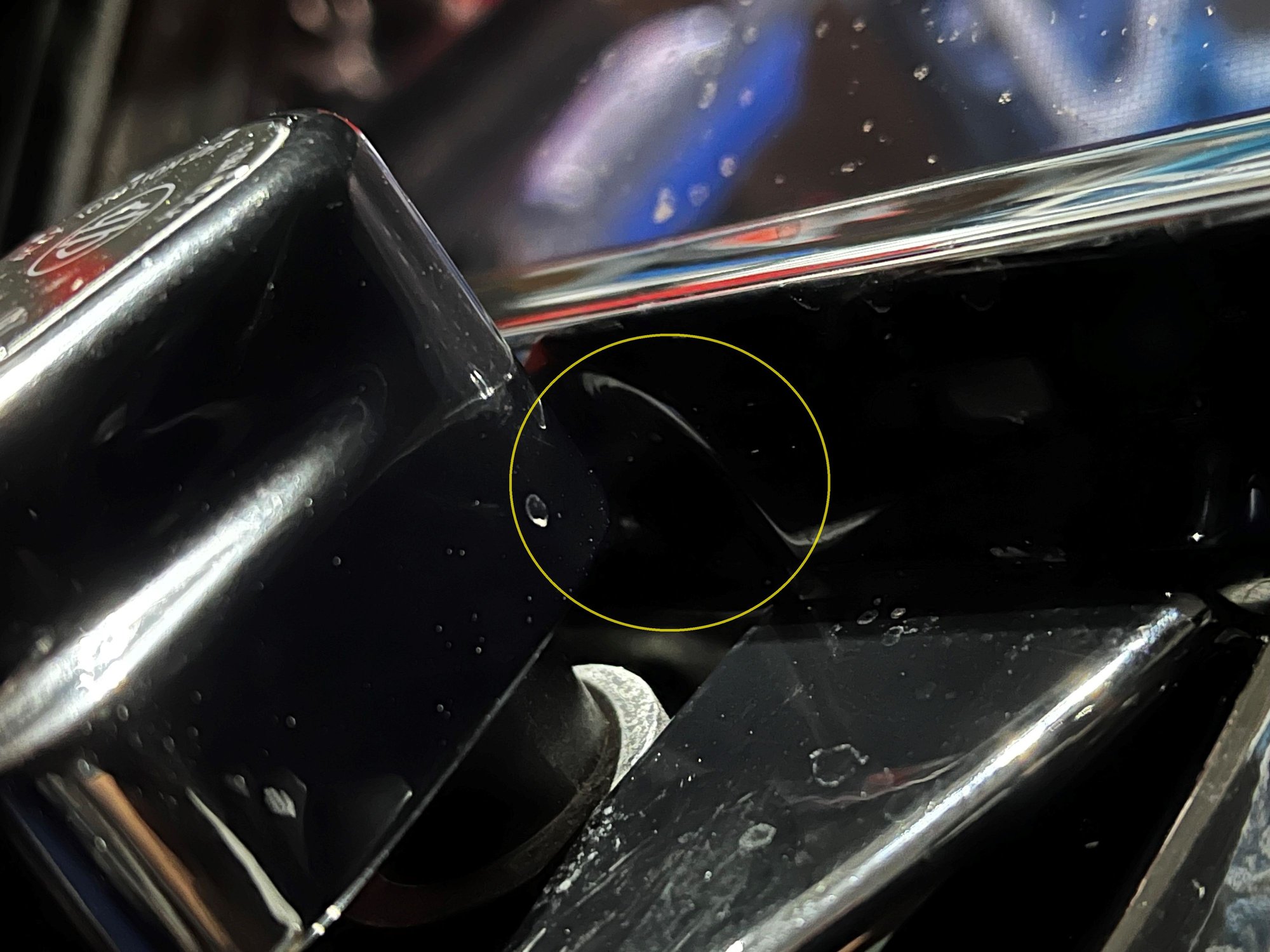

Here is a pic of my ignition switch and dash area. The "bevel" is cut into the facia/dash, not the frame of the head unit. I think you are good to go unless somebody else knows differently:

I Installed a GTS made for a SG on my 15 RG CVO, I had to cut some tabs from the inner fairing so that it can sit flush, no biggie they snapped right off, fit was perfect...
