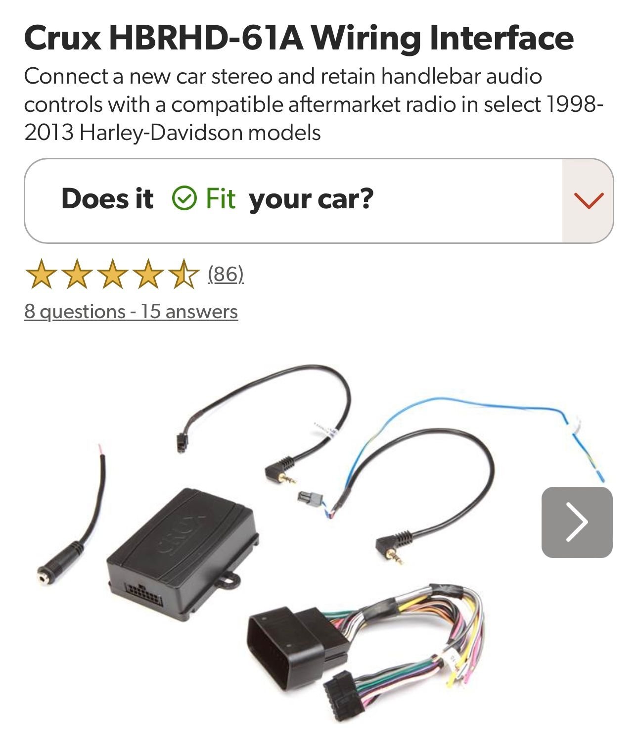

Hi all. My old HK head unit needs to be replaced in my '11 Road Glide. I only listen to music through my iPhone, so I would like to have a set up that is just a Bluetooth receiver and amplifier that I can hide in my fairing (I plan to mount gauges where the radio was mounted). Problem is I would like to retain my handlebar controls for volume/ seek etc. I plan on buying this to retain my controls
However I don't know where to go next in terms of hooking that up to Bluetooth and an amp. Does anyone have experience with this? I would hate to lose my factory controls. Thanks.

That controller won't work with bluetooth. Only way to keep factory controls is to have a headunit. You can get a Sony marine with BT, that Crux and mounting kit from Crutchfield for under $200.
