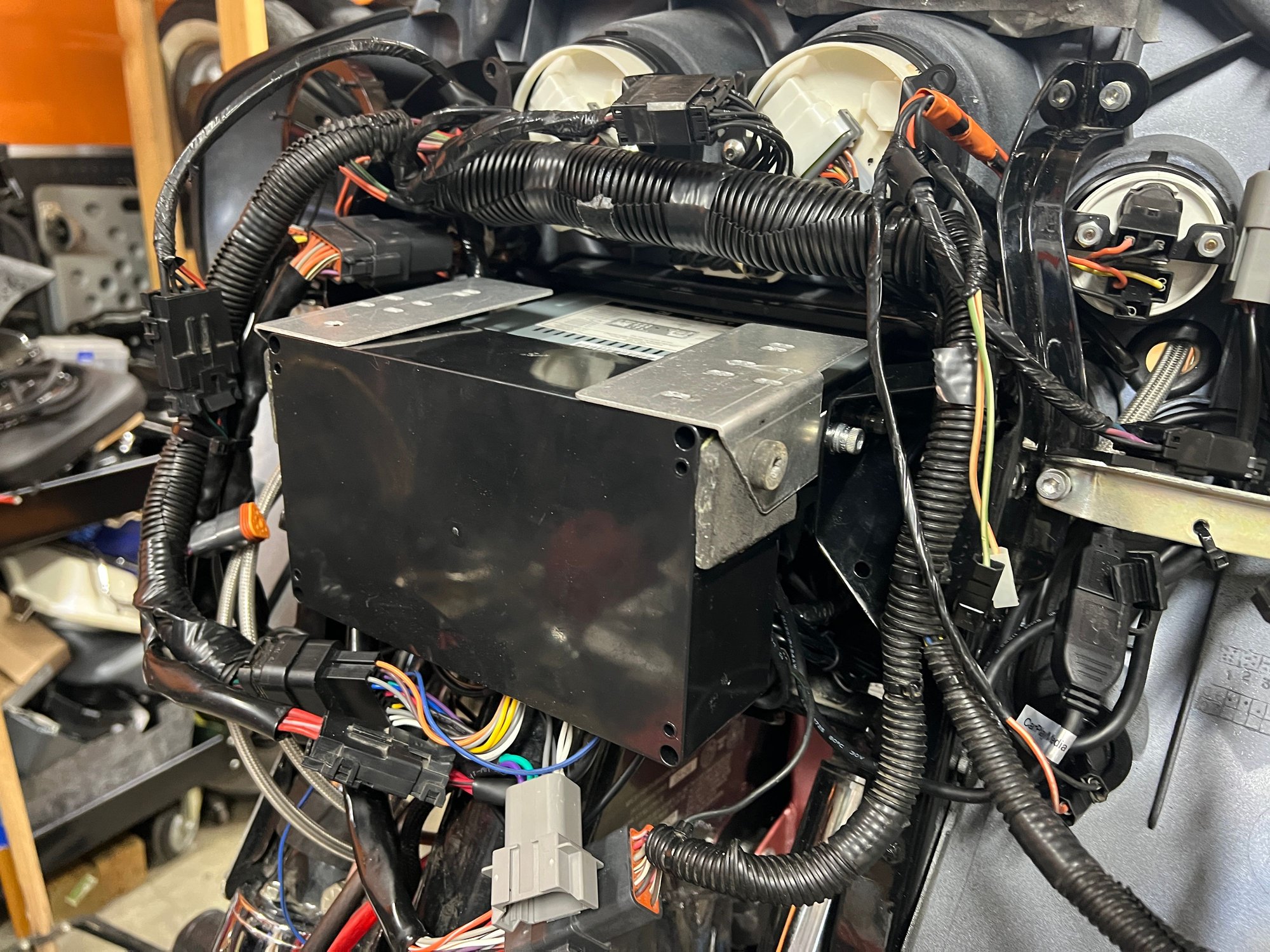

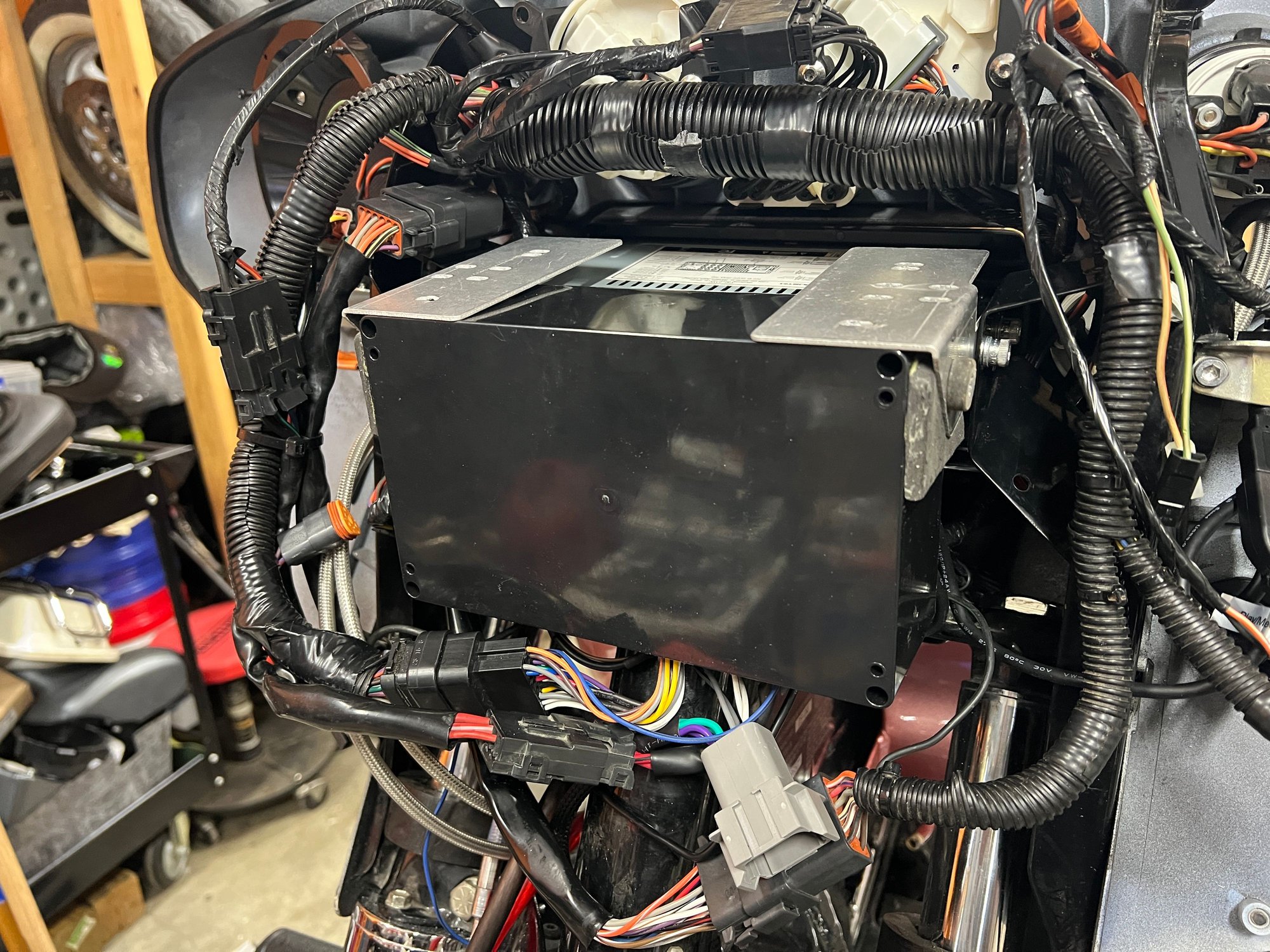

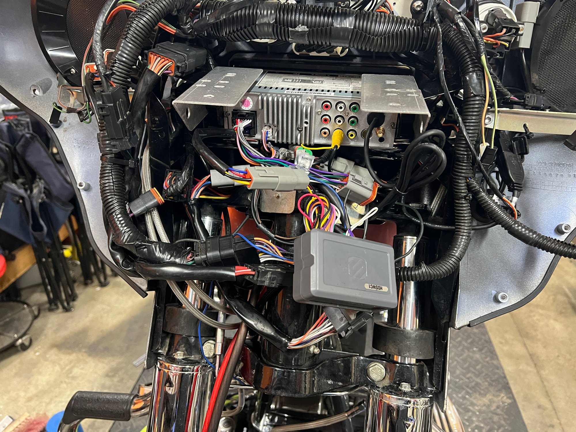

Perhaps not the best pictures to represent what I did…
Cicada Audio equipment I ordered was delayed due to weather in the MidWest, and I got bored. So. I did a thing.
All of the wiring for the aftermarket Head Unit in my 2004 Ultra Classic looked a bit hectic and I wanted it to be a little ‘cleaner’ behind the fairing.
I hacked-up an electronics project box, and mounted it on the bottom-side of the Amplifier Brackets.
Unsure if it will be a permanent thing…just something I thought I’d try. I haven’t tried putting the outer fairing back on yet…but based on the size/measurements of the OEM Radio everything should still fit.
