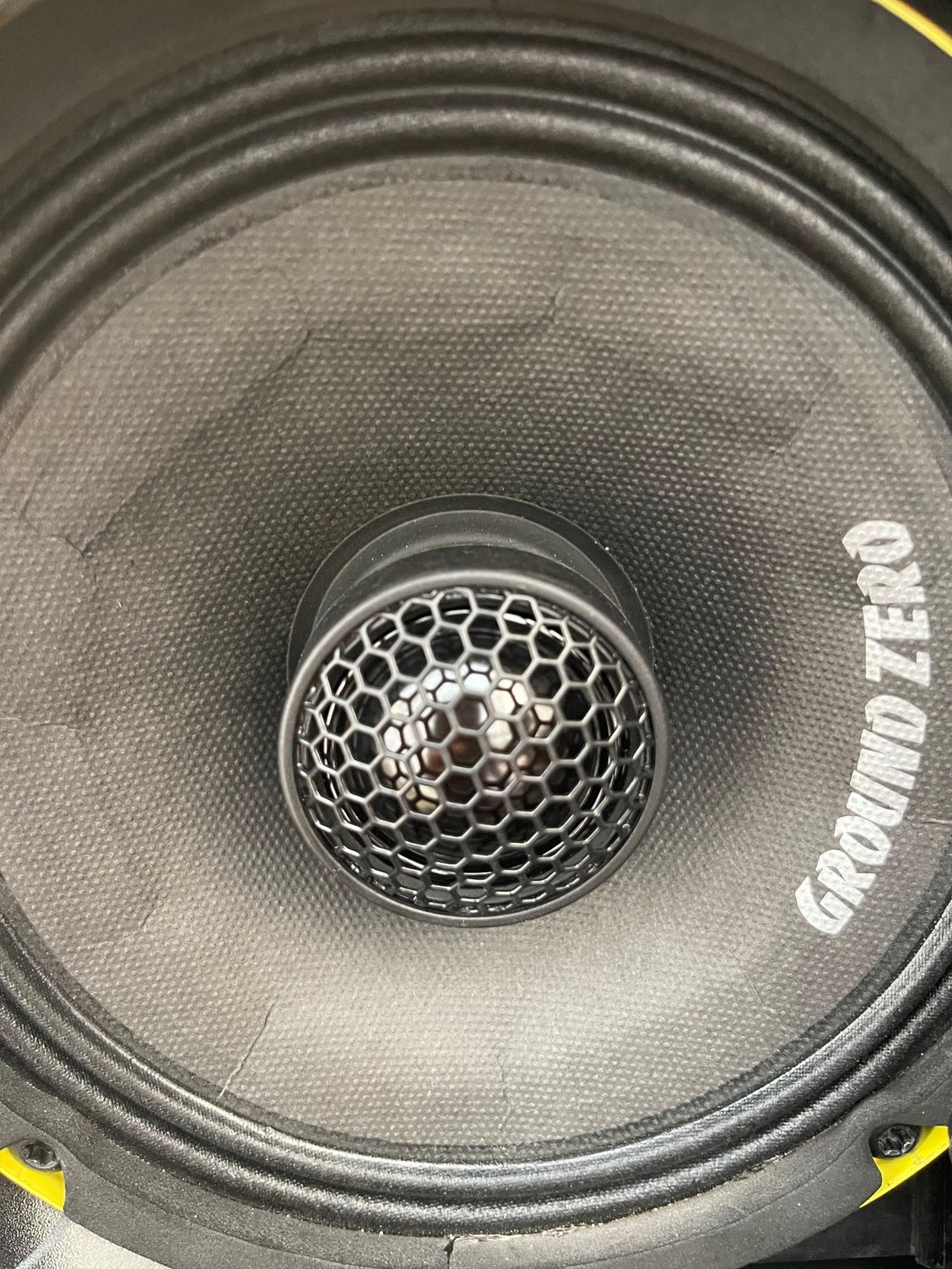

This is my speaker after maybe 20 hours of use. Ugh! I honestly thought I was being conservative going 200w and crossed at 100hz. I’ll have to go back and check everything but I’m still convinced it’s the RF tune. Obviously I’m a complete audio novice, still learning here but this was an expensive mistake.
Yeah that's definitely not from 200w...unless you had it crossed significantly less than 80hz.

I remember there was another thread with a picture of a GZ yellow that looked just like this.
