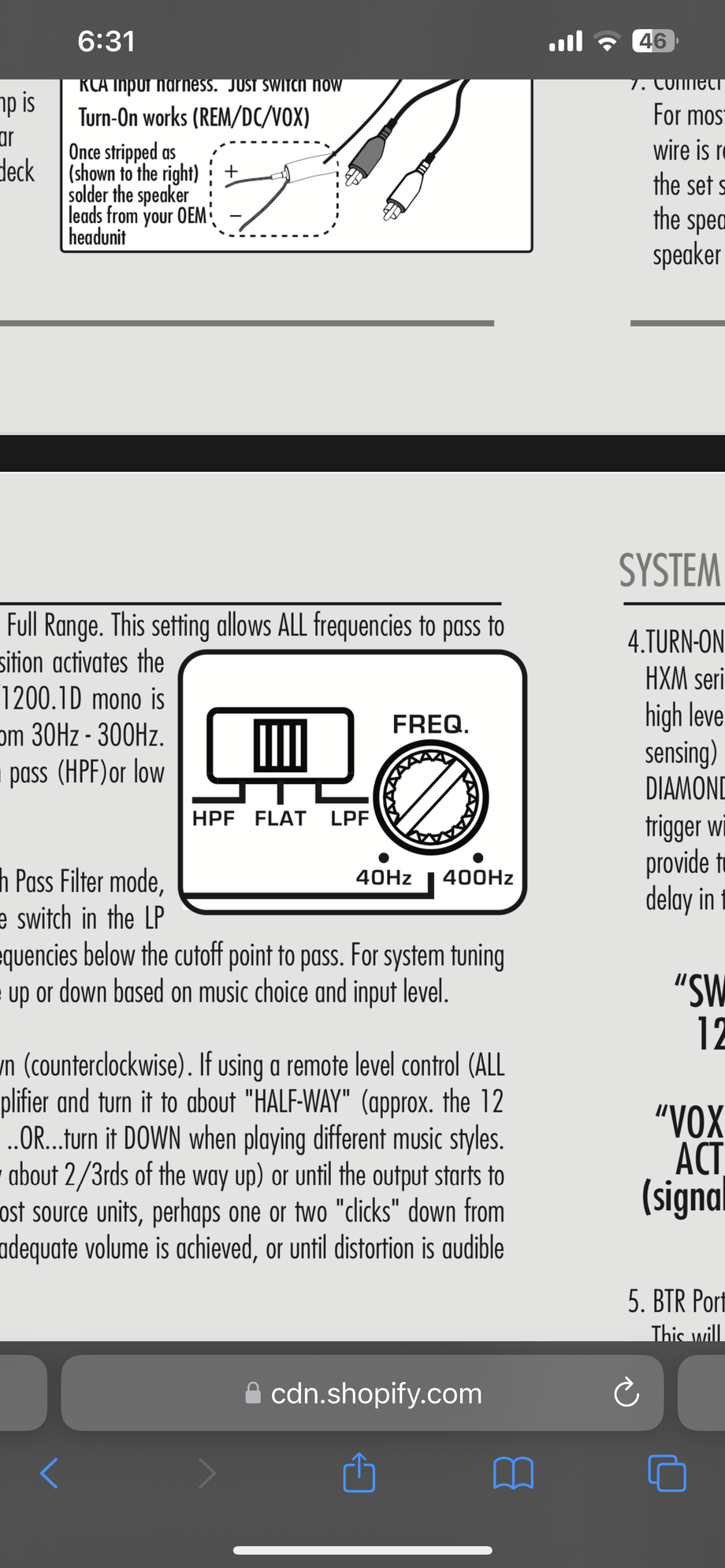

Here is the manual for the hxm800.2. Here’s where maybe I messed up. I found the median between 40 and 400 hz and that’s 220. I assume that would be at the 12 o’clock position. The median between 40 and 220 is 130hz, which I assume is at the about 9:30 position. The median between 40 and 130hz is 85, the 8:30 position. I was shooting it be closer to the 8:30 position but ended up closer to the 9:30 position.
are my calculations correct?
Yea seems accurate to me...but even at 85hz, with 28v, they should not be distorting.
What if you play them at 4 notches down from full at 85hz? Does it sound fine? And if so, when you click that one extra notch up, does it distort? If so, I would try resetting gains @ 4 notches down from full and see if issue returns.

My opinion is you did everything right. And I would probably keep the HP at 120 if you're pushing 200 Watts. Don't forget those pots can't be that accurate at 8:30 or 9:30 or 10:30. If you hear Distortion that's what you go by. What might be 100hz at 9:00 on one amp could be 120hz at 9:00 on the same model but different app. Sometimes you just have to use your ears
Unless you have a way to correctly set the crossovers on the amp like a CC-1 you are just guessing at the frequency you are setting the crossovers at.
The pots they use on the amps vary from piece to piece within X % of tolerance. So setting them the way you described, maybe at 50hz or 120hz in one position or another.
