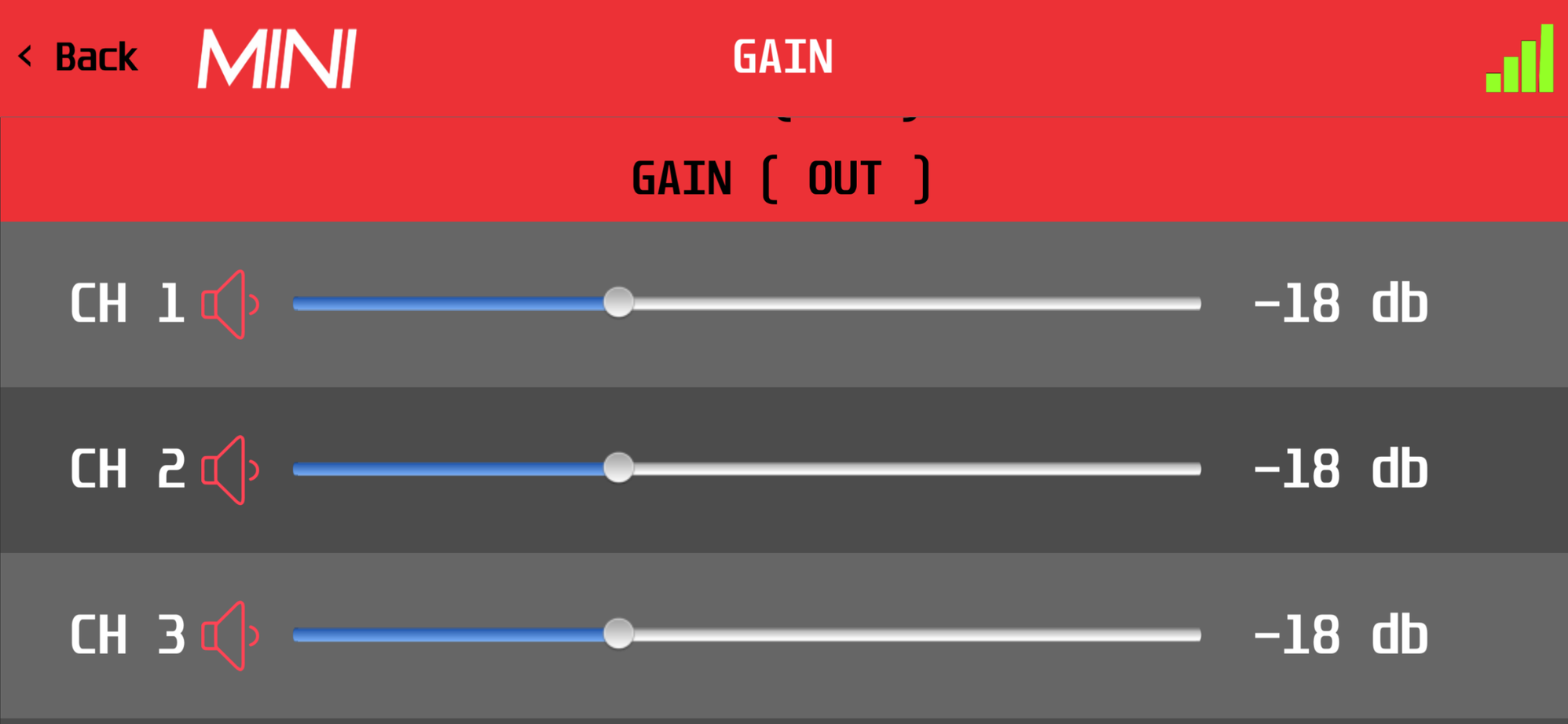

Go into "GAIN" and then make sure the speaker next to the channels are like this and don't have a line through the speaker.

OP I'm running those Hertz in my lids and they sing with only 200 watts. I could probably get by with less but I have a severe tune on them due to how my old ears work.
If you are not familiar with a DSP it is easy to accidentally shut channels off while learning. Sometimes you just need to get your routing right other times it might be an accidental mute. This video might be of some help.

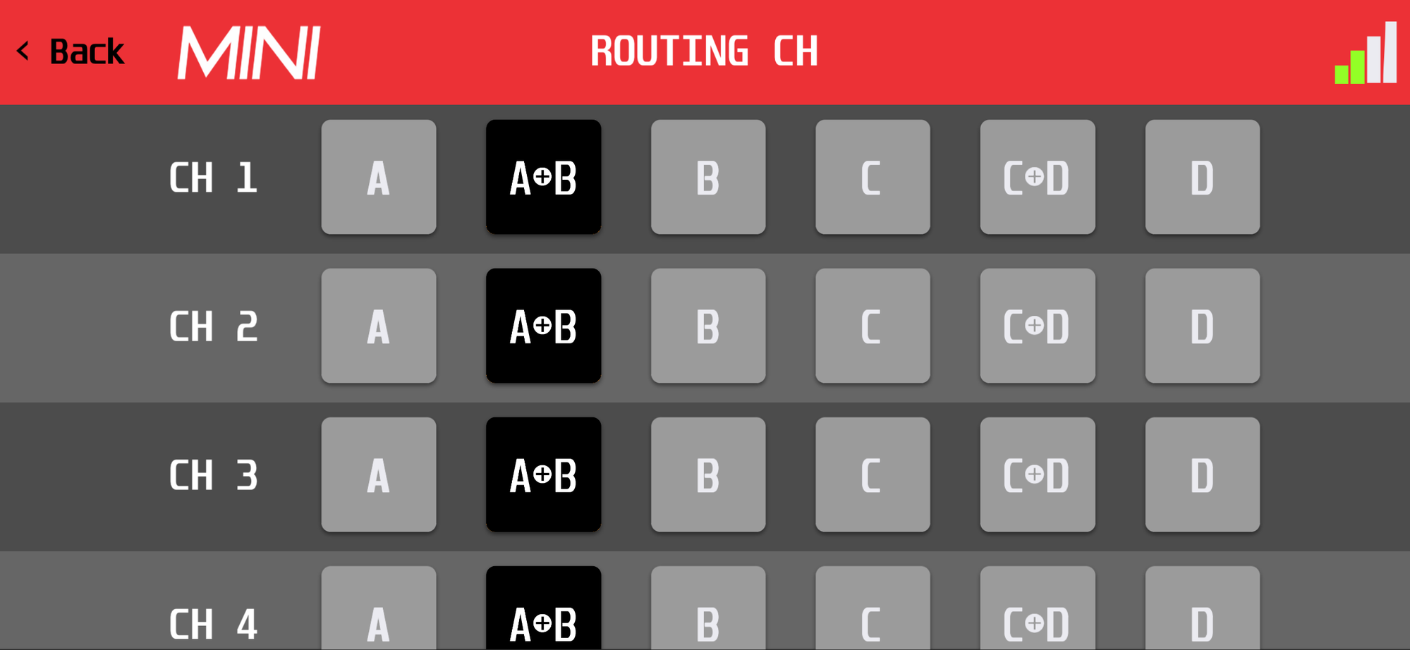

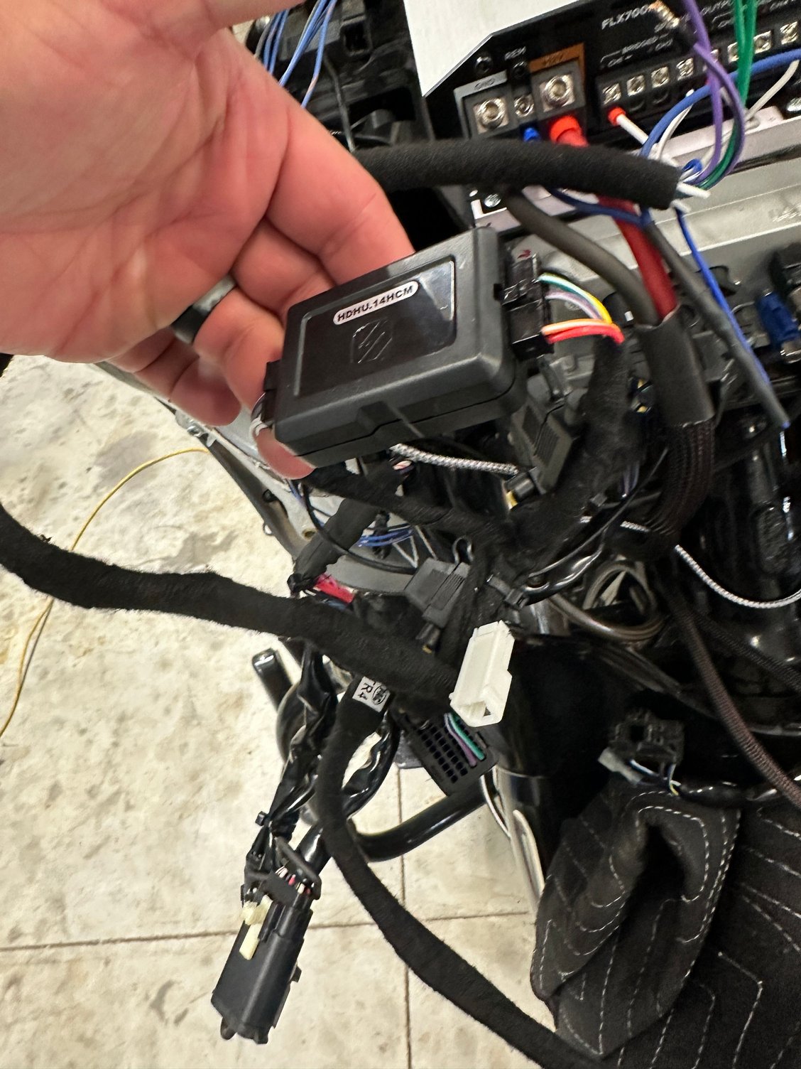

Here is how the DSP was sent to me.
Old May 9, 2025 | 02:23 PM
cshocker's Avatar
cshocker
Joined: Jul 2016
Posts: 2,216
Likes: 672
From: Andover, MN
Ok, yeah that from NVS. Carlos will get back to you and get it figured out. I guarantee it.
And that DSP is tuned.

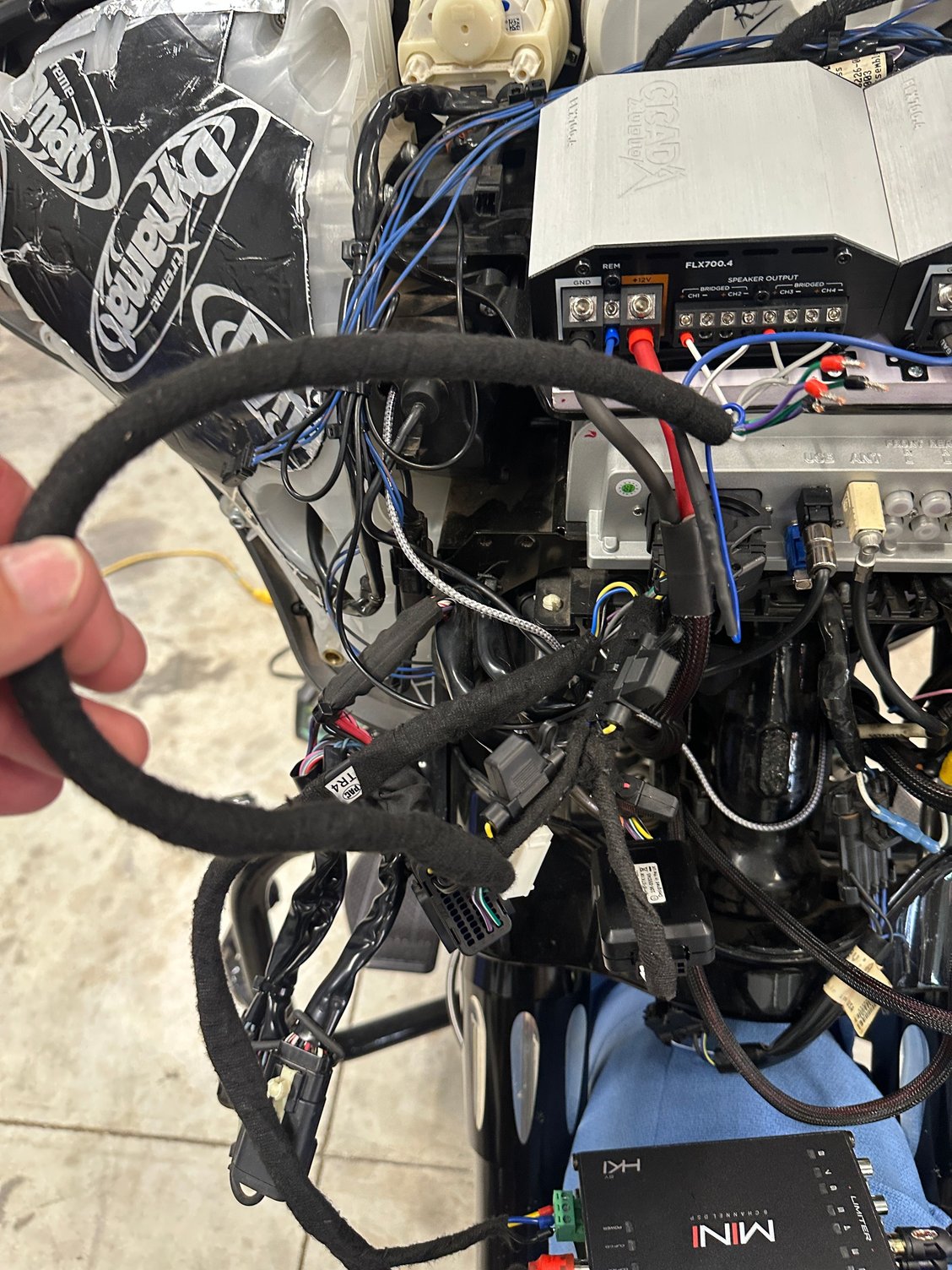

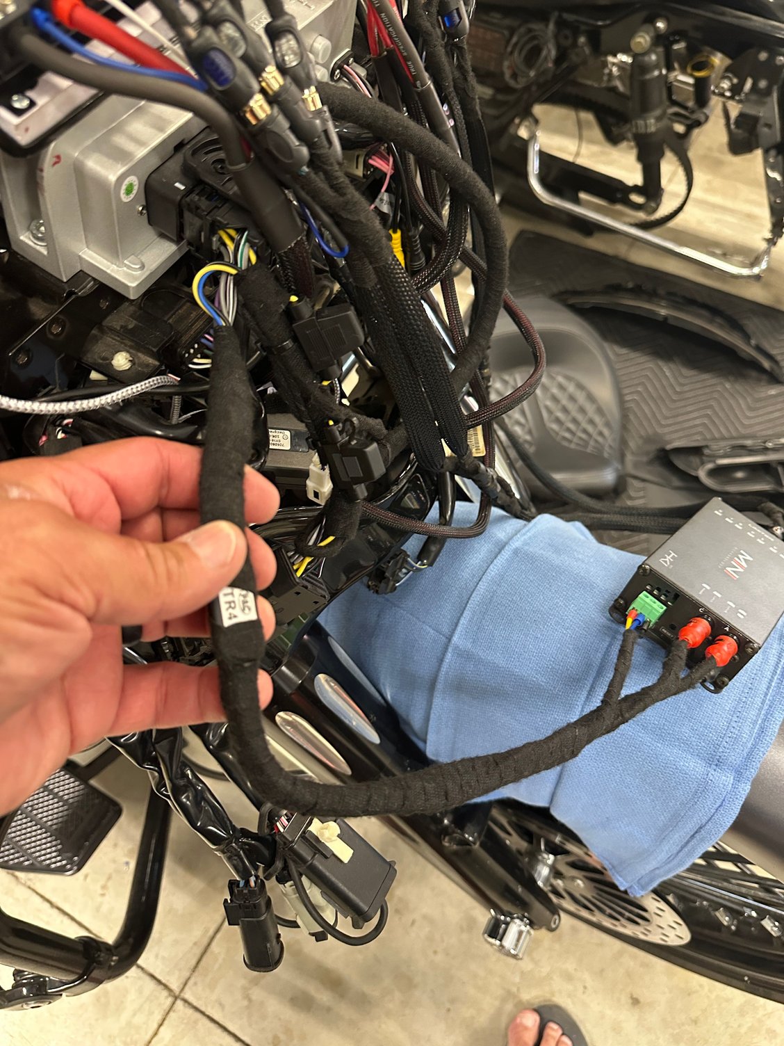

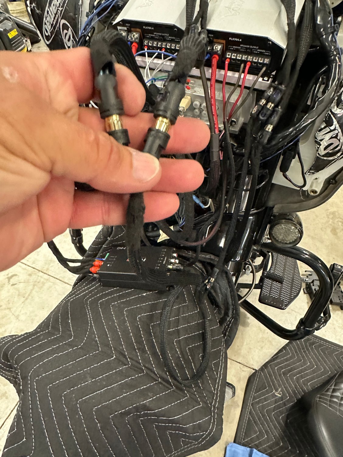

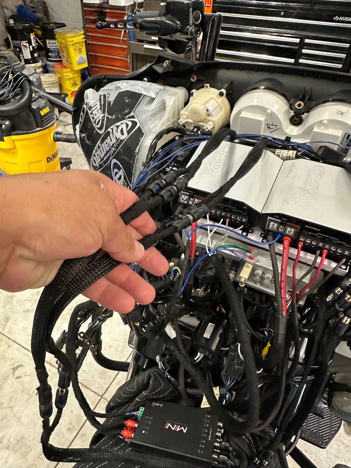

Pictures of how t-harness runs to DSP, DSP to amps.

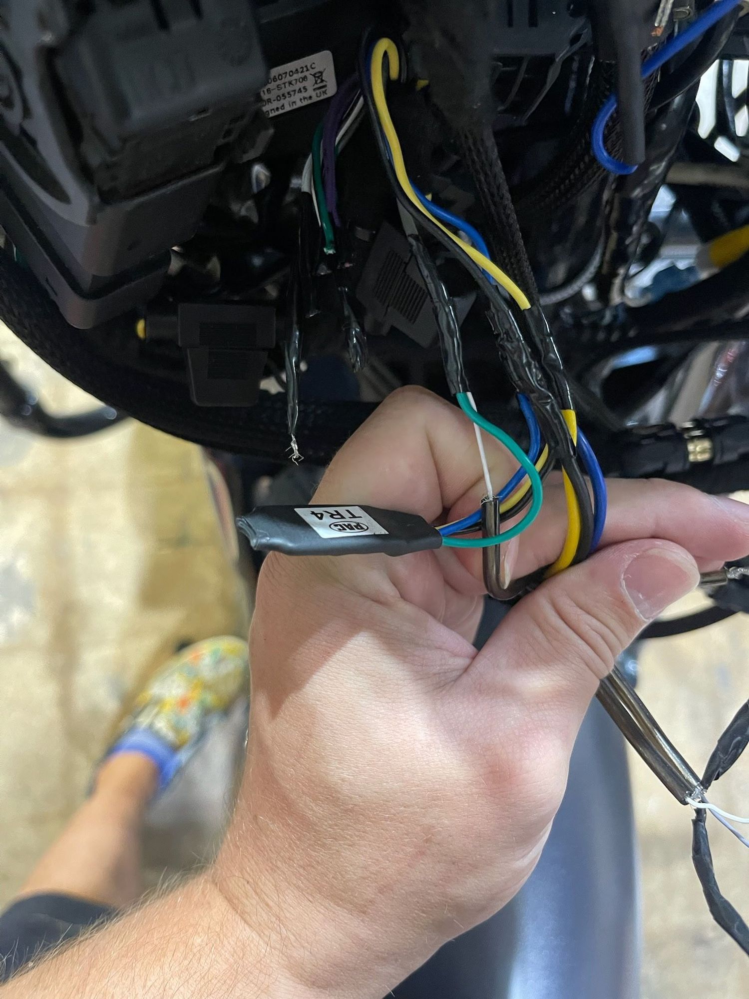

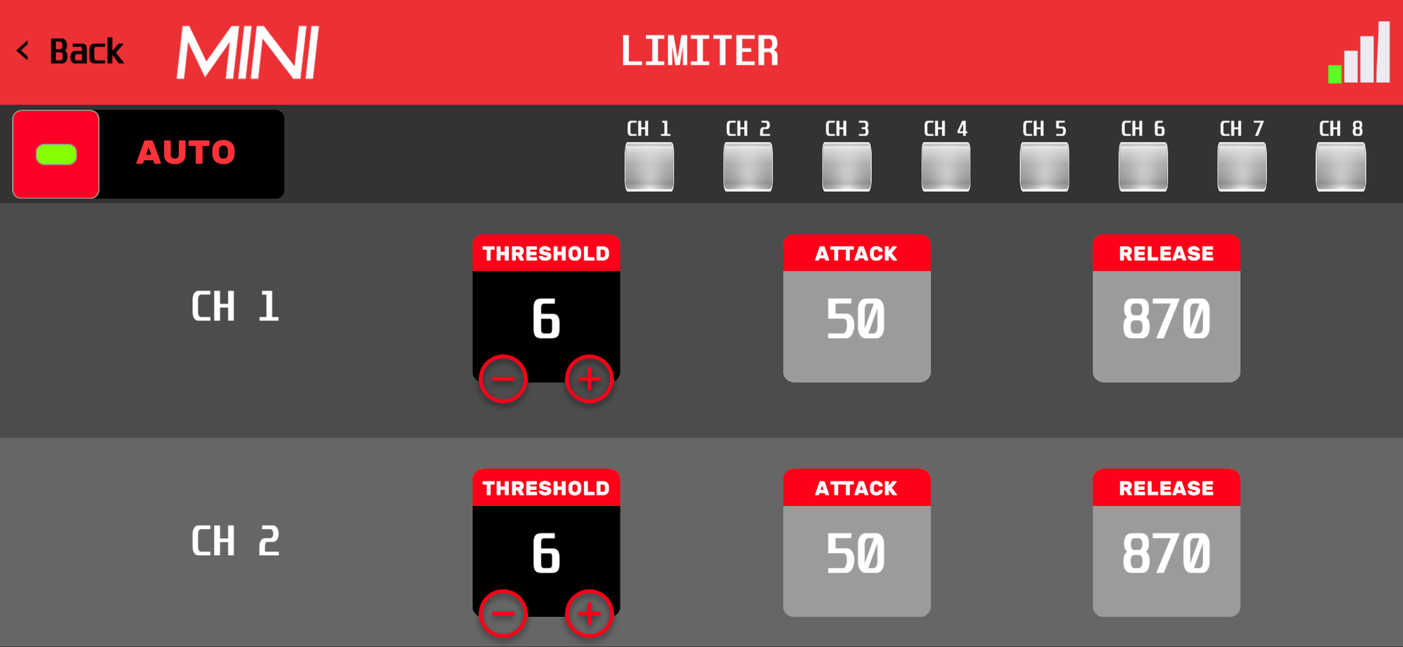

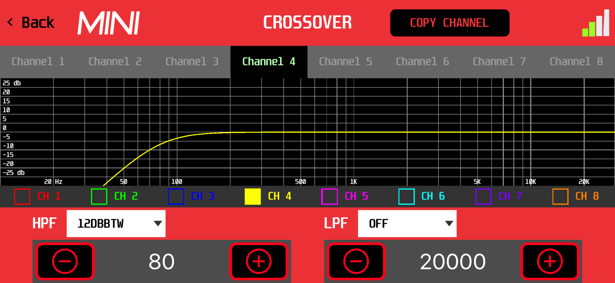

Well I finally figured out my problem with the noise and speakers not working. I removed the tesa tape and found the problem. I have corrected it and everything works. I could use some guidance for DSP settings.

Wow. That looks like electrical tape instead of heat shrink. Not sure what to think.

It was, also bare wires touching each other and causing grounding problems.

Dang. Just so we know who to stay away from do you mind telling where you got this kit from?
