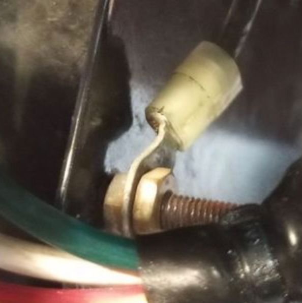

Not knowing what year/model bike you are talking about, it's hard to say for sure....
I would be surprised if you have a Harley Bagger without a frame ground or two under the fairing.....
There is also one where the battery cabel grounds to the frame, but a fairing ground would be easier to run...
Check the electrical diagram for your year/model bike and it will show where they are.
Here si a pic of a ground, under the fairing, on an older EVO Electra Glide. They don't all look like this, but it gives you an idea just for a reference.
