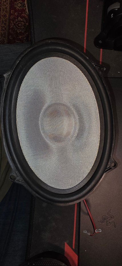

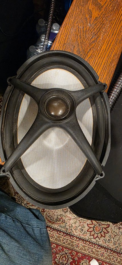

So I am getting conflicting reports on my bike and I am needing to try and get some insight if you might be able to help. 2013 Road Glide CVO 110th AE. Everything I can find shows that it should have the Boom audio system. there is a small MTX amp in the front fairing and one in the left saddlebag. I have attached pictures of the speakers that I pulled from the bike as well. The saddlebag speakers (in the first picture) look like they're supposed to be Kickers based on what I can find. the front fairing has, what I assume are, 5x7s with tweeters built into the grill and independent tweeters as well (Pictured).
I am trying to find out if I can swap these out with standard 5x7 speakers or not. I have heard that HD used a proprietary mounting on the speakers, so the grill mounts will not work with standard 5x7 speakers. If that is the case, are there any other known brands besides HD OEM and HogTunes that will fit int he mounts?

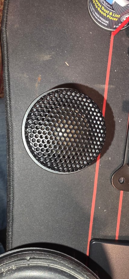

I am looking to replace the fairing grills because they have an integrated tweeter built into the grill itself that cannot be removed (pictured). But again, the aftermarket grill replacements for speakers all seem to indicate that they cannot mount standard 5x7 speakers. So I am at a loss here. Please let me know if you have any information or insight into this. One of the front and rear speakers each are currently blown so I am needing to replace them and I am trying to find speakers that will work outside of the OEM and HogTunes offerings.

Your CVO likely had Boom. originally, but it's been heavily changed. The stock front mounts are proprietary, so standard 5x7s won't fit. You're stuck with Harley/Boom!, HogTunes, or custom adapters from a shop.

2013 was before Boom! came out. You should have a Harmon radio with MTX amps. They did us dirty on the CVO by using the 5x7 (4x6) speakers. You need to buy non-cvo speaker grills and the non-cvo speaker mounts. Then you can use an aftermarket speaker adapter and put 6.5" speakers in. I have a 2012 CVO RG (not ultra). I bought the non-cvo stuff through the dealer.
ETA: I used a 5x7 in the fairing with some modifications to the speakers. You won't get better sound, selection is very limited, the 6.5" round speakers perform better.

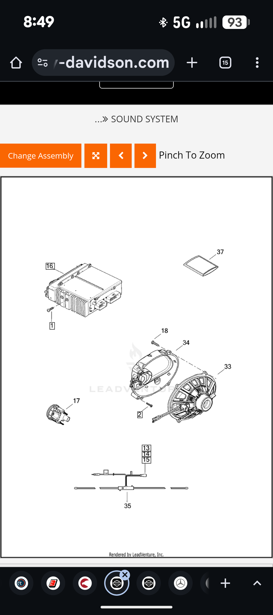

Top pic is what you have
Middle pic is what you need
Bottom pic is the part numbers for the non-cvo grills and mounts.

That's awesome! Thank you very much! It does have the little MTX amps in the fairing and saddlebag. The original head unit was HK, but that unit was having some problems as well, so it got replaced with a Soundstream unit. While I was doing that, I figured it would be a good time to replace the old speakers and that's how I got into this whole mess.
Where did you get those diagrams from?

I used to use Ronnie's parts finder, it's no longer online. So I had to use the Harley parts website.
I have no problem getting online with Ronnies........cant order from them but the parts finder and diagrams are there.
