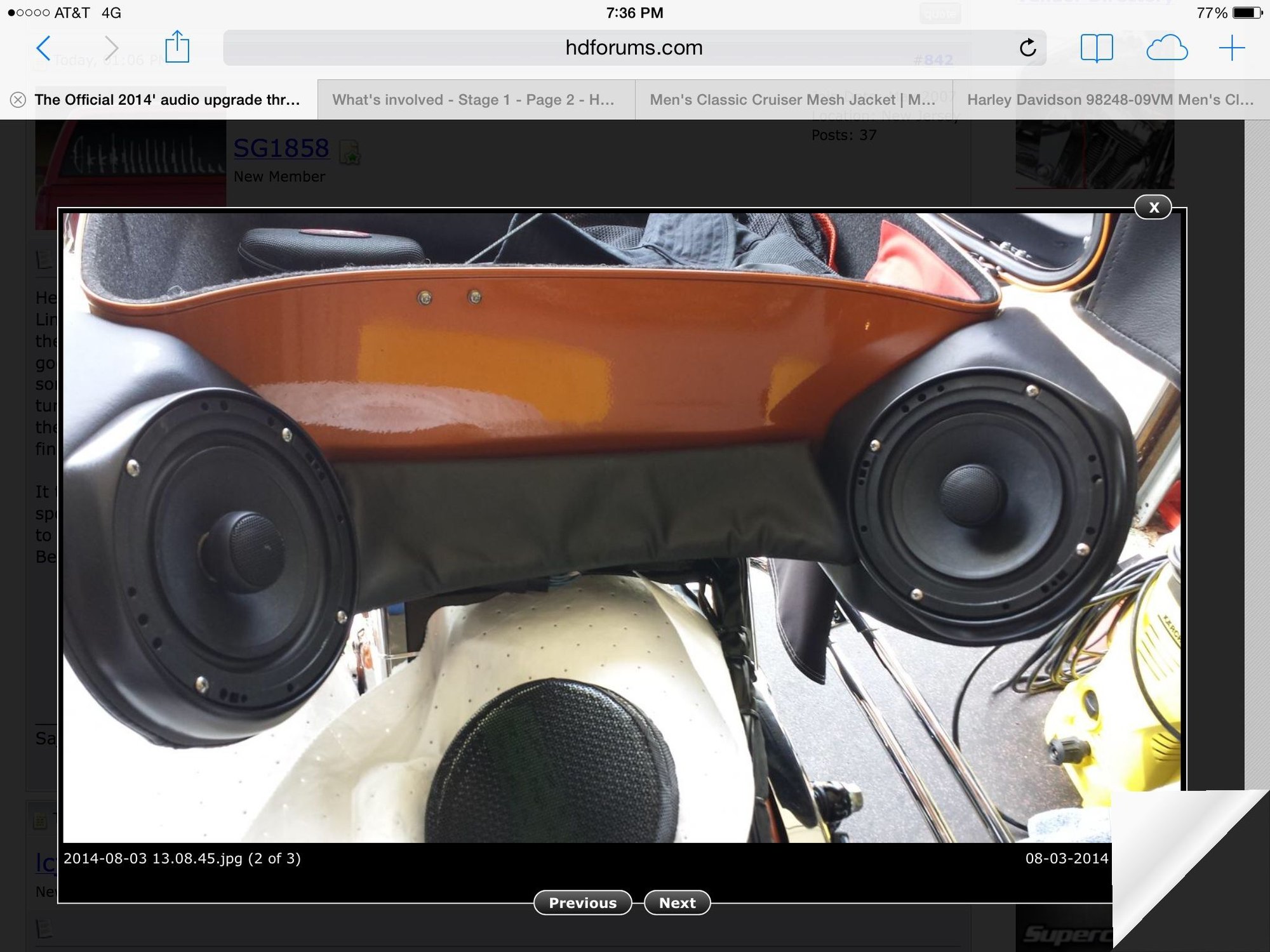

I believe that if you look back at post 842 in this thread SG1858 actually did get the BT 6.5's in the rear pods by using the adapters from Vtwin. I have already bought the adapters and I sure hope they work as I think the Titians would sound great in the rears! I am waiting on BT to get the 7.1 Pro issue worked out for the fairings so that I can figure everything out.
Are those the biketronics 6.5 in the rear pods is there a part number for the adapters?
