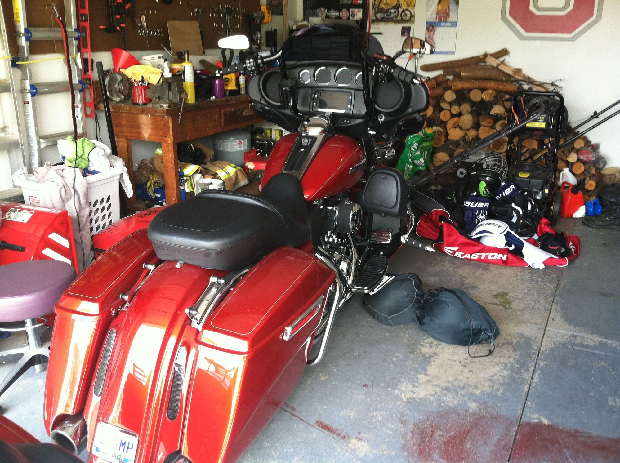

Are the BT7p1 Proline speakers and the BT4180.14 amp worth the extra money? I have a 2014 Ultra which I've made in an Ultra glide. I want to add an amp and will be running most of the time with a tour pak and the rear speakers but when the wife isn't tagging along will take it off. They have a kit for $1,389.85 which is the proline speakers and the 4180 amp. I know they give a forum discount but would like the ability to add lowers later if I want. What speakers should I put in the rear pods? Thanks

Nice looking bike!!!
The BT Pros will probably won't sound that much better than the non-pros running off of the BT amp. The Pros need more power to really shine. In that price range check out the Focal 165KRC speakers or the new version Focal EC165. They KRC's have been discontinued and can be found at a discount price. Check with LL247 for a price, he's a Focal, Arc, Hertz, etc dealer here on the forum. Or check at Crutchfield. With the BT4180 or the Arc Moto 600.4 amps for that matter you can run two pair of speakers off of the front channel in parallel as long as they are the same speaker or another speaker with a sensitivity rating very close.
As or the rears TP pods, if you want bass go with the Moto 602, or you want bright go with the BT6.5's. Both these speakers will need spacers to install. V-twin Audio has a spacer and grill kit that will work. If you want a dropin pair of speaks go with the Polk mm651 speakers.
These are suggestions and there are several more speakers and amps to choose from.
