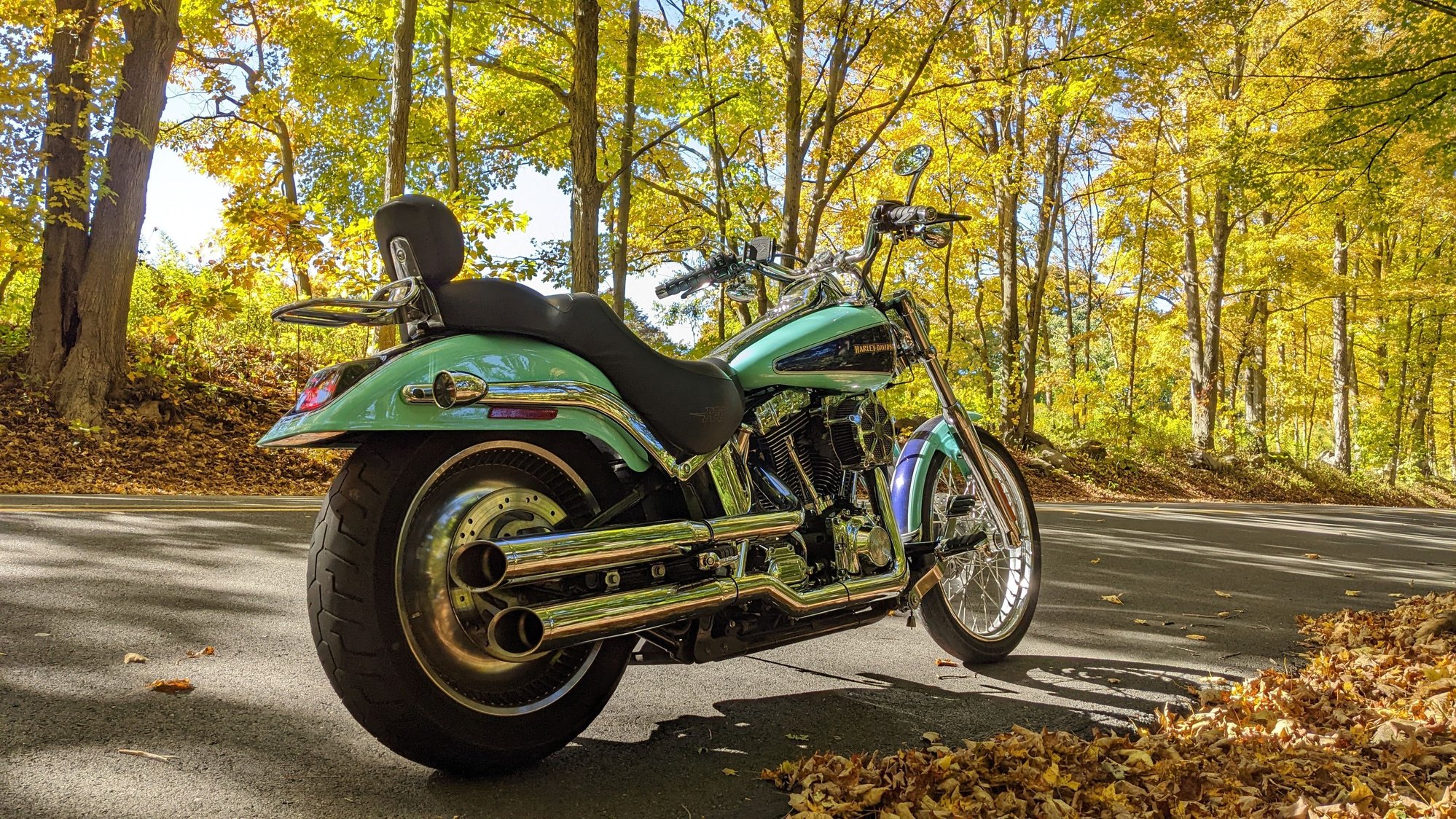

My 2002 FXSTD Softail Deuce has been running great until recently. It now has issues starting when hot, like when stopping to refuel, and never had these issues before.
A little history... Bike is well maintained and has had the carb refreshed with new slide and gaskets, as well as being cleaned. Jet, pilot and mixture all stock, never had issues. Since then, I've installed a high flow air filter and had no issues. Then I installed Cobra slip-on mufflers and it seems that I've started to have the hot start issues since then... or it maybe it's a coincidence.
All I know is whenever the bike is hot, like when I stop to gas up on the road, it will take forever to restart. I almost kill the battery trying to get it started. I've tried choke, no choke, throttle, no throttle, etc but I can't get a good start when she's hot. It's getting embarrassing at gas stations.
Any ideas? Thanks.

Since it started with the new muffler the first thing I would do is remove the Cobra Slip-Ons and put back the old mufflers and see if that fixes it.
You mentioned you put on a high flow filter and now upgraded the exhaust without any mods to the carb.
You may need to re-jet the carb just like you have to tune an EFI bike when changing the air intake and exhaust.
Nice looking bike BTW
