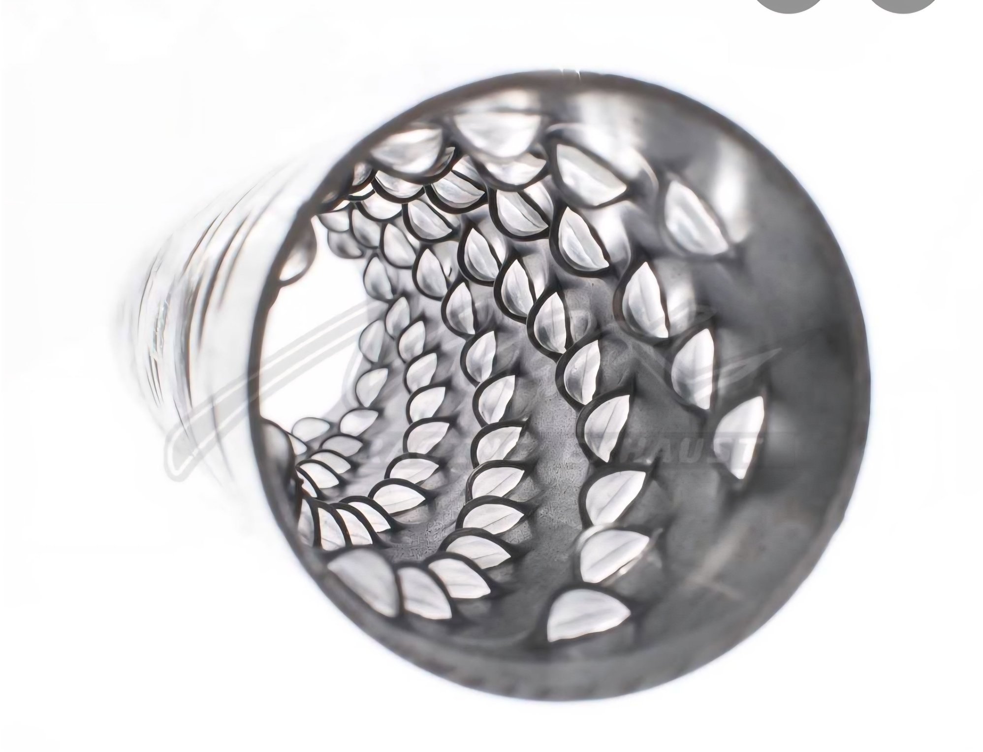

These are the baffles I was thinking of installing.

that is a good baffle design and helps stall reversion but length matters. golden pipe are not necessarily a lean out. that area is at the hottest part of the system. many factors can cause this even a rich mixture still burning while exiting the head.
my experience is 2" will out do 1.750 pipes. a quirk is that they usually need to be very long and a baffle is a band-aide and mostly effects sound. each machine is diff so experiment is called for.
drags are for WOT so you WILL have to compromise you cannot have it all.

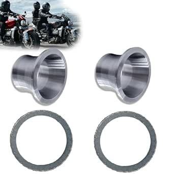

I ran reversion/torque cones in my sporty with drags, worked well. They slide in the top of the pipe.

I've used card cleaner and even soapy water but no leaks. Ive seen those torque cones but dont know anyone thats used them.
