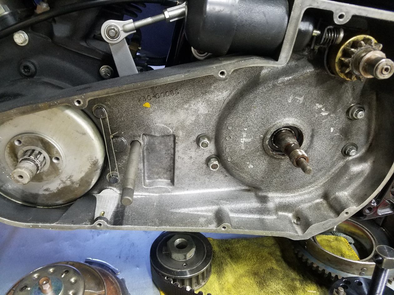

Hello. It's been a while since I posted why can only be good) I have a 1981 Sturgis that i bought last year and has a leaking crank shaft seal. I pulled off the clutch and belt drive assm but need info on removing the inner primary. All the shovelheads i had in the past were kick only and this has kick and electric. Do I have to pull the starter motor or can I pull the inner primary out of the way slightly to get at the seal. If i do have to pull the starter what is the easiest way? The shop manual does not provide any detail information on this. I have enclosed a picture. I have since removed all the nits and bolts..

the crank seal is under the alternator drum and the inner can stay in place

Ok. how can you get the alt cover off? when I removed all the inner primary bolts it did not seem to move that much. thank you
