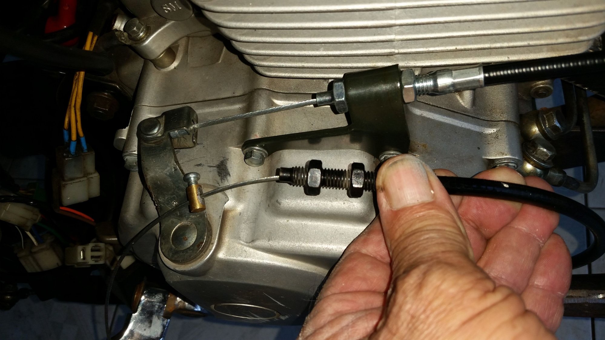

To further explain, I guess better is:
The Jockey shift will be right handed, as Indian Motorcycle. Then Clutch cable will run from Clutch (Right side of Engine) tp Factory cable adjustment screw as sown in picture (black Bracket) to left side of engine (Chrome Bracket). Cable will then attach to top of Foot Clutch pivot at base of foot lever (1:00 position). Pulling cable forward when clutch depressed. Foot pedal also has a cable connection at 05:00 position. If I connect Hand clutch cable here, when hand clutch squeezed, will pull foot clutch back. also depressing foot clutch which will in turn engage clutch. I will have to use same style cable adjustment bracket here also, welding to frame. I have 6 LED's 5 red and 1 green all at reduced power that I have been using for gear indicators as 1st gear is engaged one LED will light, as each gear is engaged another LED will luminate. So when in Top gear all 5 will be lit. I am also thinking of adding a Bracket around shift lever which, like Ingian is on right side of fuel tank and adding these LED's in same sequence of shift pattern.
This way she (Wife) can used either left hand or foot to engage Clutch, so when stopped, she can if needed use her feet to steady Bike, right hand to select gear needed then either right foot or hand to use brake if location warrants their use. so she will always have access to clutch and brakes. Bike idles beautifully at 900-1100 RPM. Looking down at shift lever (jockey Shift) will tell her what gear she is in.
I know this is confusing I will attach Picture of Indian (side views) I have shown idea of shifter placement and linkage idea, only thing I have not shown here is Aluminum Guard (Plate to protect shift handle and LED's) It will attach to tank on right side as Harley's did on Left.
David
Please any Ideas on this??? Or should I just not give Wife this Ride???
Using this idea on right side of Bike. Then linkage bracket on left would extend thru frame to left side of Bike....
using pivot on right to extend to right side of bike thru frame then using factory linkage connect pivot to shift lever on left side of engine . relocating angle to either pull up or push down to change gears.

I understand what you are trying to do and it sounds like you have thought it through.
"when hand clutch squeezed, will pull foot clutch back. also depressing foot clutch which will in turn engage clutch. "
Wonder how hard the hand lever will pull in order to not only disengage the clutch, but also move the foot lever as well.
"Or should I just not give Wife this Ride???"
You know her better than anyone ... you have to decide if this is something she can handle ... not only everyday but in a panic situation also. Best of luck
