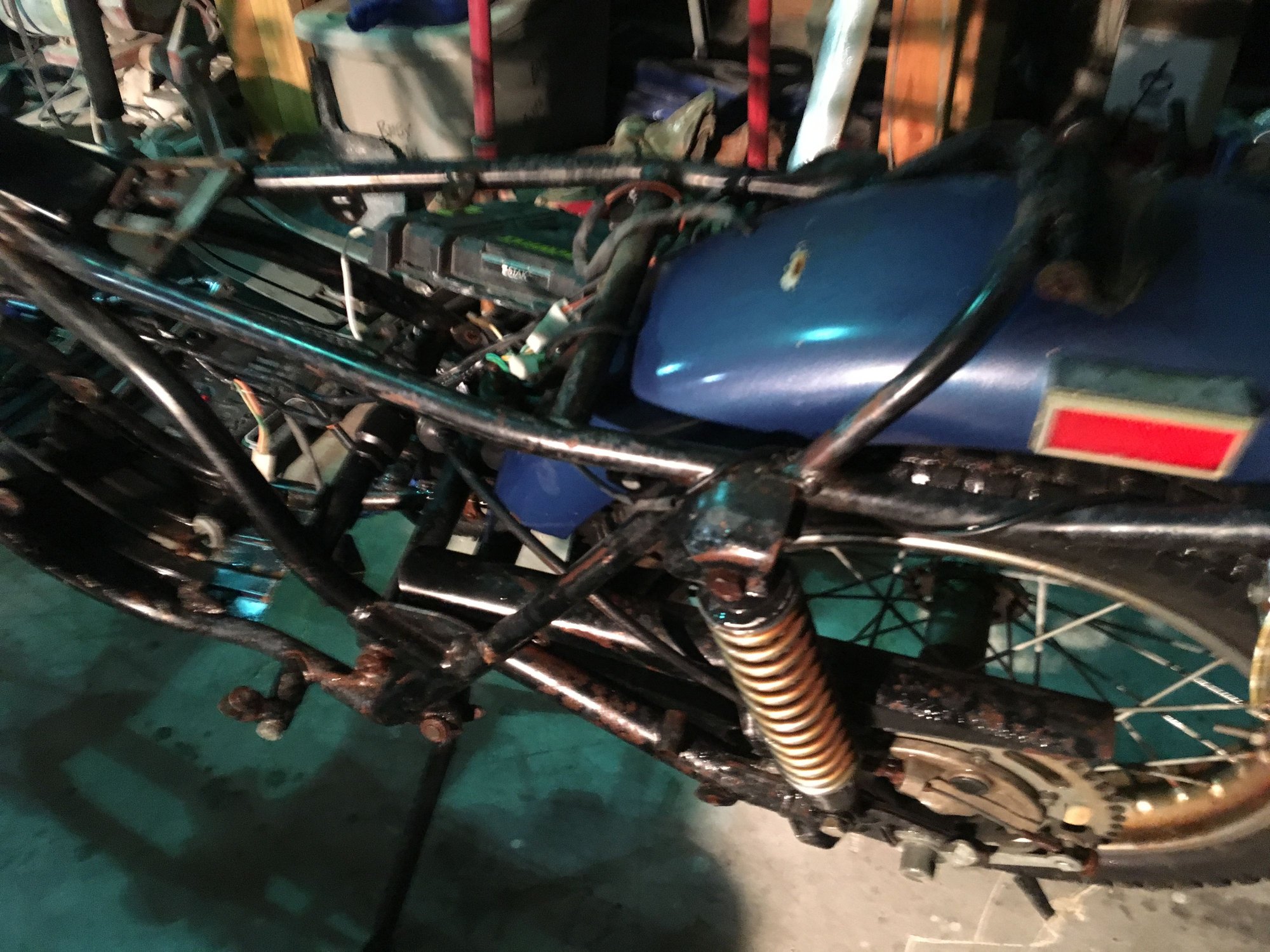

so not sure but didnt seem to fit in any forum so figured custom would work.. so i picked up 2.. well 1 1/2 harley enduros sx-250's for $350.. missing lots of parts but between the two and some 81' yamaha 250 parts i have im trying to get ridable without investing any money. just want to practive wheelies and burn outs and dont want to dump my wideglide.. anyway just wanted to see what you guys thought about these 2 stroke harleys

Parts for them are all over the Bay. I would ride it, good swap meet or pit bike. But they unfortunately are not worth much so be careful on the $$$ so you don't get upside down. For what you paid, i probably would have taken them home as well. Good luck.

so far have $0 invested besides the $350 to buy them and just about have it rjnmjng if i could get spark.. i dont see where the 12v + goes to the coil though.. looks like its a bunch of ground connections which idoesnt make sence..

so im having a hard time getting the thing to spark.. i have it all wired by the book and have power from the alt and im getting .8 ohm on the coil pickup and the coil checks out ok but i dont get how the coil gets power when the wire i thought should go to +12v actually goes to ground on the ignition module..
