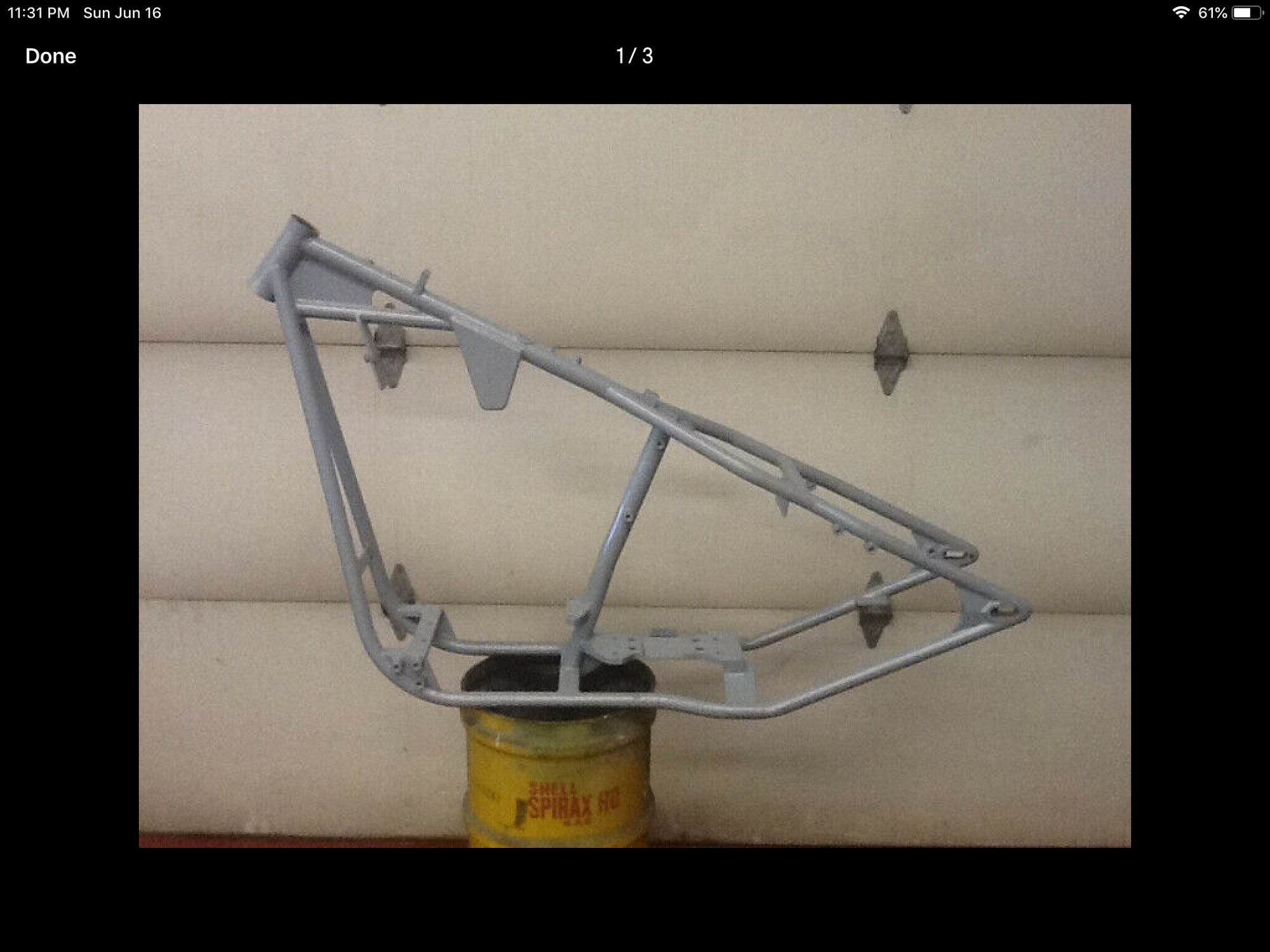

Picture wiped out my post....
34 degree rake 4 up 180/200 rear.
21x3.5 18 x 200mm
is it possible to estimate proper fork length without mock up theoretically?
I want no rake in the triple trees

34 degree neck is the same as WG which uses 27.5" tubes. +4 up=34" tubes (due to the 34 degree angle)

Sounds legit.... good starting point I guess anyway.
